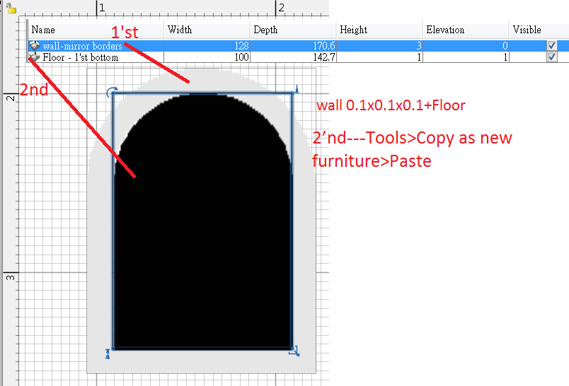

Posted by sclee at Aug 23, 2012, 3:58:23 PM
Re: MIRROR EFFECT
My steps are as follows:
Attachment mirror-01.PNG (64456 bytes) (Download count: 1123799)
Attachment mirror-02.PNG (56840 bytes) (Download count: 1123096)
Attachment mirror-03.PNG (38159 bytes) (Download count: 1130294)
Attachment mirror-04.PNG (42688 bytes) (Download count: 1129779)
Attachment mirror-05.PNG (59462 bytes) (Download count: 1137124)
Attachment mirror-06.PNG (30843 bytes) (Download count: 1133507)
Attachment mirror-07.PNG (70098 bytes) (Download count: 1133393)
Attachment mirror-08.PNG (146876 bytes) (Download count: 1132251)
Attachment mirror-09.PNG (146630 bytes) (Download count: 800273)

Posted by Puybaret at Aug 24, 2012, 11:24:25 AM
Re: MIRROR EFFECT
As explained previously, the "full" mirror effect can be obtained only for OBJ parts starting by sweethome3d_window_mirror. If you want to do it with Sweet Home 3D, this implies that you'll have to use Export at OBJ format, rename the mirror part in the OBJ file then reimport the modified OBJ file.
