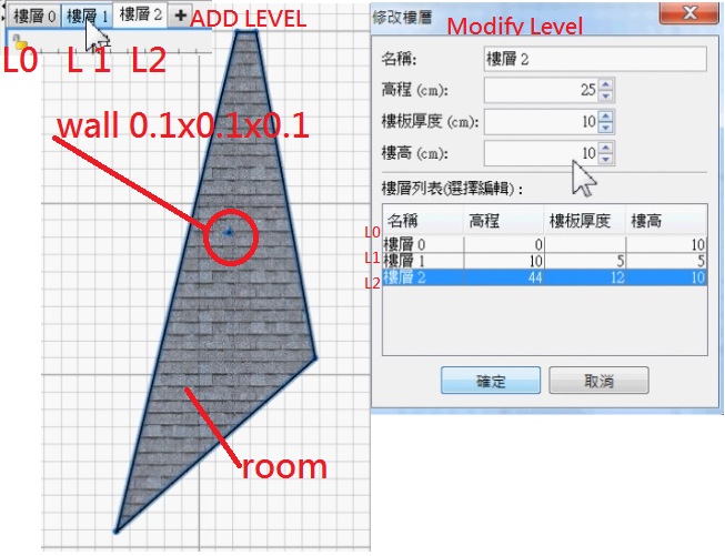

| Posted by sclee at Jun 27, 2012, 4:51:52 AM |
Re: Pyramidal roof download CopyAsNewFurniturePlugin-1.1.sh3p:Here Room cannot CopyAsNewFurniture alone, it must be “wall size 0.1x0.1x0.1 +room” together you can CopyAsNewFurniture. see:Here or Here ---------------------------------------- |
| Posted by mrtower at Jun 27, 2012, 8:16:04 AM |
Re: Pyramidal roof Actually, I got it working and now have my first roof section, by exporting each floor directly as an object, and then importing the two floors (one for white interior finish and one with tiles for exterior, and then exporting those as an object. CopyAsNewFurniture wasn't even needed (although I do have it installed). |
