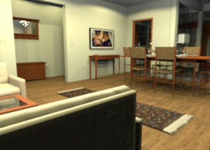

All-in-all, I tested thirty or forty different configurations, with a couple dozen logged for later reference. Eventually I had what I felt to be an acceptable blend of directed and ambient light sources -- or at least that's how it appeared based on a low-resolution rendering:
As it was nearly time for supper -- or definitely past time for lunch -- I decided I'd let the PC crank out a high-resolution version while I grabbed something to eat. After framing the shot from a slightly higher viewpoint, I decided to run one last low-res render at Quality Level 3 as a final check on intensity

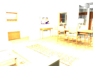

---and was met with what I first thought to be an all-white image:
This made no sense: All I had done was stand up (so to speak), changing the Virtual Visitor's eye height from three-and-a-half feet to five-and-a-half; I hadn't touched a light source or changed time of day.
I dropped the viewport back to 3'6": everything rendered perfectly. I went back to 5'6", and again the image was blown out. The same thing happened at 4'6", as well. Somehow, at 3'6" there was a sweet spot -- but nowhere else.
It turns out my Virtual Visitor was inside a speaker. A Bang & Olufsen BeoLab 8000, as I recall, which I presume must be around four feet tall. Somehow, I'd managed to drop the Visitor in exactly the right spot for most of the cast rays to be attenuated, but without any accompanying blocking or distortion of the scene. I hadn't noticed this overlap, as I had positioned the Visitor blindly: When the living room ceiling is visible, it obscures everything below. (Even with the ceiling hidden, it took me a while to find the problem; with a cross-section of only a few inches in diameter, the B&O's 2D representation was hidden by that of the Visitor's.)

Strange story! smile
I guess the speaker was covered with some kind of half transparent material through which the virtual visitor was viewing. You could have seen that in the 3D view except if that surface is very close to the point of view, because OpenGL requires the program to set an interval in the axis of view where objects will be taken into account and displayed (see viewing frustrum ), probably for performance reasons. SunFlow doesn't have this limitation and this may result in a different result for very close objects.
