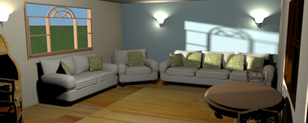

here is sample, ceiling ,left wall and right wall are at different 3 colors,includind pure white(right wall) but result is same in create photo selection?

I tried using the Advanced Photo renderer with different wall colors: 2 are beige and one is blue. As you can see, the colors are very soft, you can hardly tell that the 2 beige walls have color.
My settings:
North is at 60, the time is about 1:20pm, Silk walls, ceiling, and floors is set to "off" but I did use the Silk rendering setting with ceiling, lamp, and sun checked off (meaning the box is checked). The power for the wall lights is set to 40%

i really appreciate for your advice and sending sample with settings.here is the settings u gave, and the result pic, my problem is: i changed all walls color to beige but in aerial visit view and in result photo pic left wall always seem to gray, that gray color is about to make me crazy!!! any advice aboput that u have? and also do u use 16/9 setting or 3d view setting for the photo , i used 16/9 as u can see,and my lens is always default(if this is ok)..also, my room never seem natural-realy pic like...!!!!!!!! why??? where i m wrong at???? (north position is arranged for my home angle but it didnt work anyway which is not important now when im having problems with inside of home: walllls!!!!! :(:(:(:(
