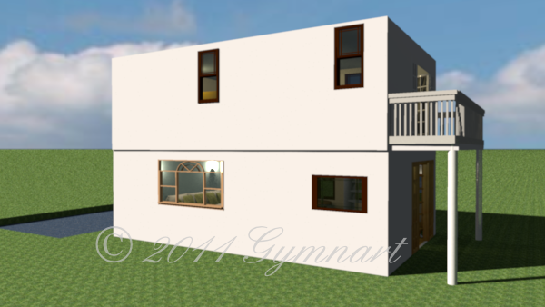

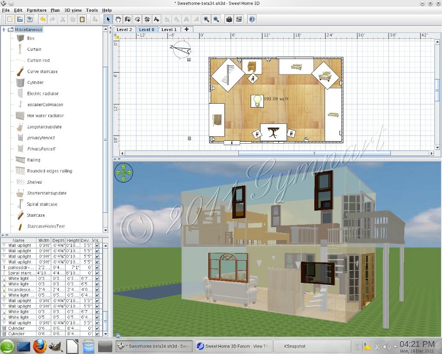

Great work Emmanuel!
I made a swimming pool in the back yard of a house I'm testing. I also made a "basement" but it's more like a crawl space. You can't see it unless you go down there.
I'm attaching snapshots so you can see.
- Sweethome-beta34outside-web.png (188.39 KiB) Viewed 2704777 times
- SH3D-34betafunweb.jpeg (142.65 KiB) Viewed 2930985 times
