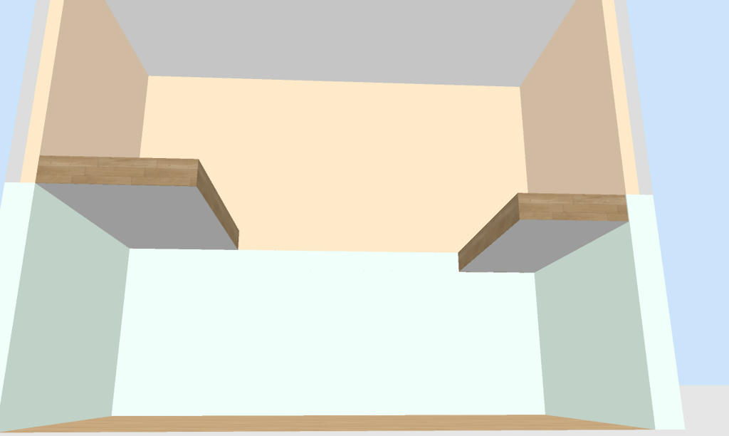

I am designing a simple rectangular building. At one end, the loft/mezzanine needs to have a ground level ceiling height of 210cm. At the other end, another loft mezzanine needs to have a ground level ceiling height of 230cm.
I am making my way through this tutorial: http://www.sweethome3d.com/blog/2015/08/29/how_to_design_a_mezzanine.html
I understand it, however, because the top level can only have one elevation, the walls are not going to match up, as they are lower on one side of the ground level than the other side (ie. 'uneven', or not the same wall height all around the ground level).
I would greatly appreciate any hacks/workarounds/suggestions as to how to achieve two lofts/mezzanines with different elevations within the same block, from any clever person who knows a way.

I think i see what you are after, i have made a file where i created this -:
if it is something like what you need then you can download it HERE , you will need to take note of the elevations, wall heights and room modifications.
Good luck, looking forward to seeing some images in the gallery. smile

Thanks Mike - I very much appreciate you going to that effort for me. I will analyse the file and let you know how it goes. Sorry I didn't reply earlier, I am new to the forum and thought that I'd get email notifications if there was a reply, but I checked it manually and saw your post.
I'll post an update within a day or so. Thanks again.

Hey Mike - replicating the steps in your file was of huge benefit to me. Not only could I see what you did, but it made me learn a whole stack of things that I would've otherwise asked. Without your help, it would've taken me ages to figure out that levels can be used like that.
