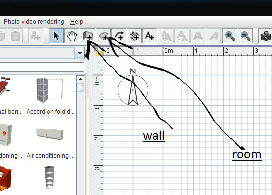

The "room" tool is to the right of the wall tool
Select the tool, double click inside your walls, right click>modify room> uncheck ceiling as Hans says, you can modify the floor texture while your at it.

P.S. make sure all the walls are joined together, room tool will not function correctly if there is even the smallest gap.
