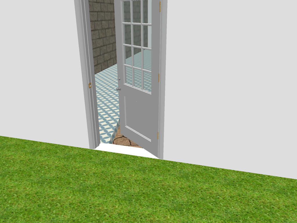

Question: Is it normal for a basement level to show a lip protruding over the ground? The basement floor elevation is negative 7'9 7/8". The mail level still shows 0' floor elevation. It's the first time I created a basement level and an upper level. Nothing bad seems to be affected. I tried making the basement two ways: 1) add new level and set the new (negative) elevation, added walls/room/height, and 2) add new level at same elevation (as main level) and set the new (negative) elevation, added walls/room/height. Both do the same thing. I'm assuming this is normal with the current SH3D version. I was watching older YouTube videos and the basement appeared flush with the ground. Here you can see the edge of the added basement level "lip" on the edge of my main 0' elevation level. Part of my kitchen has indented walls on its floorplan. Maybe by design SH3D overlaps floors with no harm?

Hello, I tried to reproduce your problem..without success !
You can see the floor of the basement , and the floor(blue tiles) of the level 0 . I made a notch in the floor in order to be able to see the basement floor.
It seems that your wall is is not at the border of your room .. Did you check you don't have two rooms stacked on top of one another ?

Here's just the basement level viewable. I used measurements from my actual house. Been double checking them. The basement walls are not higher than the negative floor elevation. The wall height plus the main level floor thickness equals the total basement height to ground zero. That 1 5/8" thin floor is due to the hardwood floor and wood sub-floor (with framing support underneath) between the basement and main floor.
Or should the basement wall height equal the basement depth? It doesn't work that way with the other levels though. Also, the indented gaps you see on the kitchen exterior shot is due to the interior room shape. Later that will be covered with an even brick wall layer.

Ah, I fixed it. The default height for new walls was set to 8'0 1/2" that's used for the other 2 floors. I selected the basement walls and changed then from that to 7'8 1/4" now it's correct a little below the surface to account for the ceiling thickness.
