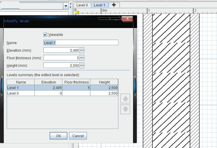

You could try this Create a level 5mm below the height of your wall with the floor thickness set to 5mm draw walls to fill in the gaps create a texture, something like "Paint" draw black diagonal lines on it import the texture and use it as the floor texture remember to un-check the box's for area and ceilings when modifying the room. Here is a very quick attempt

And why not simply drawing an additional thick wall to fill the space. Walls with the same pattern which overlap are drawn in the plan as it was only one wall. You could also look at this tip.
