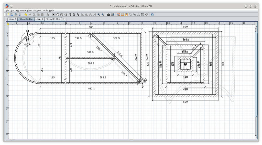

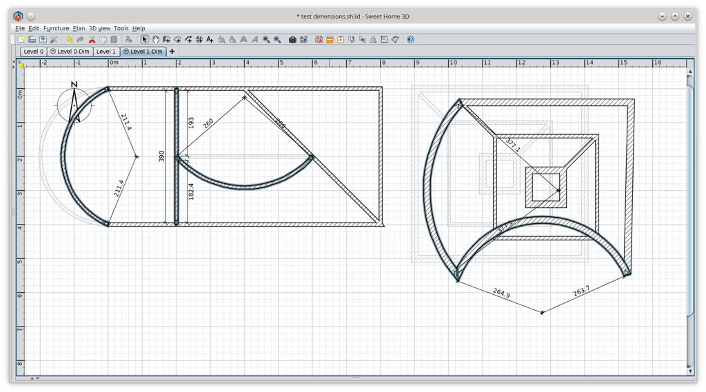

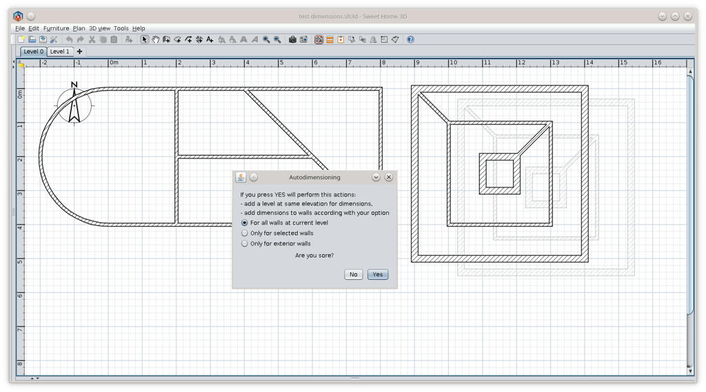

As usual, YAUP. "The Hell are paved with good intentions" This subject was on this tread but without source code. I tray to reproduce and ad inner radius for curved walls. Wile I'm not a programmer, use it with care! Could be launch from Tools->AutoDimensioning... or from icon on toolbar. The plugin with source code could be downloaded from AutoDimensioning plugin or from sourceforge Some screenshots: Good luck!

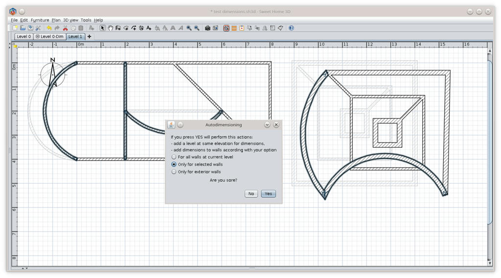

really nice question 'Are you sore?'
Wasn't with intention. On next version will be "Are you sure?" TODO also in next version: - implement somehow the exterior walls; - to align exterior dimensions; - to add walls thickness. At that moment, to align dimension lines, I don't see other solution than select the lines and than align them with another plug-in. I will see what I can do or maybe someone else could do this.

@ Hans My unique neuron is a little bit lazy. I need a new test_dimensions file and I know You can do this. Maybe a screenshot with how to look Your desire dimension lines. Especially for curved walls. As You've already observe I've use one of Your file for my sample. I need one or more files to cover as many possibly situations but also not too unavailing complex.

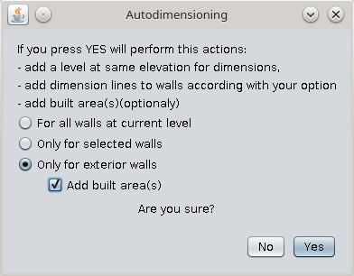

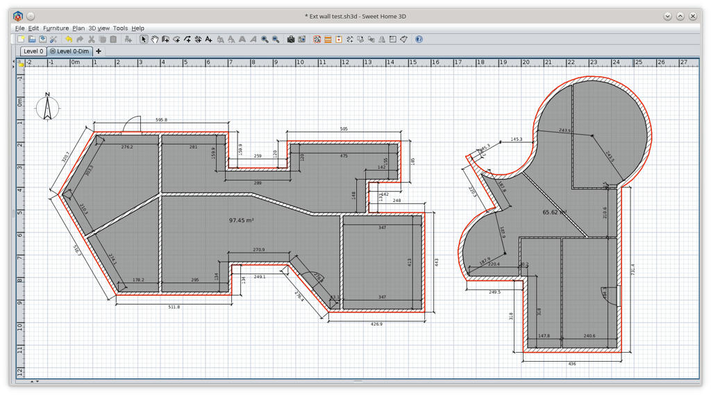

New version 1.1 Download AutoDimensioning v1.1 and from SourceForge . @hansmex Many thanks for help! You have to download this version because is a little bit different. News: - fix some bug in message and translations; - implement exterior walls; - add built area(s); - all adds are in separate level at same elevation. Some explanations: Hint: To have ONLY the built area chose "Only selected walls" with NO walls selected and check the "Add built areas"
The built area are composed by a room and a poly-line. I need it probably for a roof plugin.
PS. Please verify my translations in English and french. I usually make a lot of mistakes.
