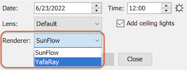

This new version includes YafaRay rendering engine which you can activate with the new Renderer dropdown list shown in photo and video creation dialog boxes (which can be resized now). The default engine remains SunFlow at the moment but this might change in the future if the YafaRay is a fully stable solution.

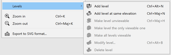

- Plan menu items handling levels were moved to the Levels sub menu to reduce the length of this menu:

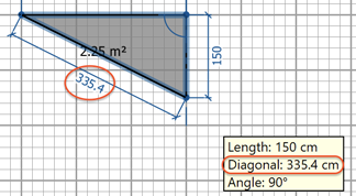

- It's possible to enter the diagonal value for the current point in the room creation tool tip to be able to draw rooms by triangulation:

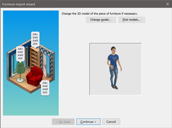

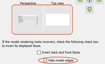

- The Hide model edges check box was added to the second step of the Furniture import wizard to hide easily edges of DAE files available at Trimble warehouse (this option is visible only for 3D models with material names starting with edge_color). The following screenshots show the difference when this new option is actived or deactivated.
- The last step of the Furniture import wizard lets you now zoom and rotate the model around two axes to get a nicer icon of the imported model.

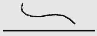

There's no limit in the depth of the shapes tree you may build with this rule. For example, you can build the model of a flexible hose with ten segments or more if you have the patience to design it.

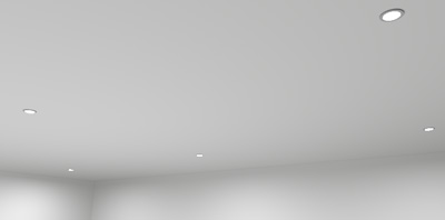

- The lightSourceMaterialName# property was added to PluginFurnitureCatalog.properties of SH3F furniture libraries to define the material(s) of shapes which should be used in a 3D model as light sources at the two best quality rendering levels, for example to define a light panel or a ceiling mini spot with a thin light surface.
The default power of such light sources depends on the brightness of their color and their surface. To be able to compare their power with existing light sources, the power of a 10 cm wide sphere used as a light source will be the same as a white light source which is initially set to 10 cm diameter in Sweet Home 3D default catalog.
As a shape used as a light source may have a very large surface, you may have to enter a small Power value in its furniture modification dialog box to make it usable, the reason why you may enter a decimal value in Power spinner now.
The color of this kind of light source will come from the default color of its material (for example, using Kd parameter in a MTL file) or the color set by the user in Sweet Home 3D furniture or marterials dialog boxes. If this material is set as fully transparent (for example, using d 0 parameter in a MTL file), the shape(s) using this material will emit some light in the rendered scene but won't be visible in the rendering.
Note also that the shapes used as light sources are note double faced, and if you want the both sides of a shape to emit some light, its 3D model should define both faces (generally with vertices cited in reverse order for the opposite face).
To help you start with this new feature, I created the furniture library LightShapes.sh3f with 5 different kinds of light shapes: a double faced Light panel, a one faced Invisible light panel (but visible in the 3D view when selected), an Invisible light sphere equivalent to default catalog light source (but this one will emit the color you will choose in its modification dialog box), an Invisible inward light half sphere which may be used to light a scene with soft shadows, and a mini spot as seen in previous screenshot.
