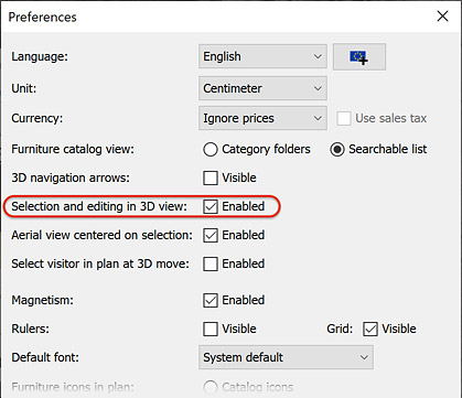

- Handling items in the 3D view:
The new Selection and editing in 3D view option was added in the preferences pane.
When this option is enabled, you'll be able to:
• select objets in the 3D view with a simple click (Shift + click to toggle its selection). Selected objects are surrounded by a half transparent blue line and the front face of selected furniture shows crossed lines.
• modify an object by double clicking on it
• use the items of Edit menu when the 3D view has focus
• move selected furniture in the 3D view with a drag and drop, where magnetism (toggled with Alt key / command key under macOS), alignment along X / Y axes (Shift key after you started to move the mouse), duplication (Ctrl key / option key under macOS after you started to move the mouse) works like in the plan. Moved furniture remain at the same elevation, and their x / y coordinates are updated according to the current view angle, while vertical mouse moves are converted to moves along the depth. Only furniture can move because I feel that there are too many circumstances where you wouldn't be able to navigate in the 3D view if other selected items like walls or rooms could be moved too.
• elevate the selected piece of furniture or furniture group by pressing the Ctrl key / option key under macOS before you start to move it
• drag and drop an item of the catalog in the 3D view to add it to the plan. Objects dropped on a wall appear along that wall or in the wall for doors and windows. An object dropped on an other piece will be elevated at the elevation defined by the dropOnTopElevation property if defined, and an object dropped on a shelf unit defining a shelfElevations or shelfBoxes property (see below) will appear at the elevation of the shelf where the object was dropped and at the middle of the shelf unit depth.

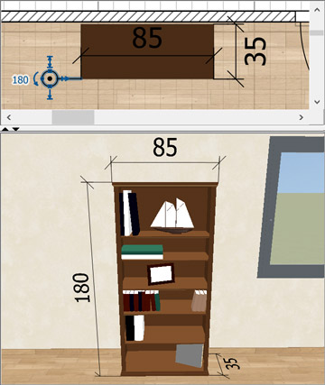

- Magnetism on shelf units:
Sweet Home 3D proposes the two new properties shelfElevations and shelfBoxes to define the locations of shelves in a shelf unit.
If either of properties is defined for a piece of furniture, magnetism on its shelves will be applied on the objects placed on them when you change their elevation, like the card game in the previous clip.
• shelfElevations property is defined with a list of numbers in cm from the lowest to the highest elevation, like the bedside table, the bookcase, the glass door cabinet and bunk beds found in the default furniture catalog.
• shelfBoxes property lists the coordinates of the boxes where objects can be placed, each box being defined by 6 values matching the (x, y, z) coordinates in cm of the left, front, bottom lower point and the right, back, top upper opposite point of the box. When you move an object placed on a shelf unit defining shelfBoxes# property, it's magnetized within the limits of each box of the shelf unit.
Keep in mind that when defining these coordinates, axis directions and origin of the describe box are as in the following image. If you have 4 boxes, you'll have to enter 24 values in the shelfBoxes property field. To help you recognize groups of 6 values, you may add spaces between values. If you wan't to be able to place objects on the top of the shelf unit, the bottom of the last shelf box should match the top of the shelf unit.
For example, the filled book case shown in above clip and available in the default furniture catalog defines the following shelfBoxes property value:
2.3 1.4 5.4 53.2 33.8 33.5   21.8 1.4 34.8 82.7 33.8 63.4   38.3 1.4 64.7 68 33.8 87.7   2.3 1.4 89 26.3 33.8 114   52.2 1.4 89 82.7 33.8 114   40.9 1.4 115.3 82.7 33.8 134.7   19.3 1.4 136 29.3 33.8 176.6   68.8 1.4 136 82.7 33.8 176.6   0 0 180 85 35 250
When the card game is moved to the right on the third shelf in the clip, you'll see that it's magnetized to the left border of the box defined by the coordinates (38.3 1.4 64.7) and (68 33.8 87.7).
This is helpful to fill a bookcase more quickly, but depends also on how patient you'll be to define all these shelf boxes in the 3D models you'll create. Anyway, you always have the choice to define shelfElevations easier property instead.

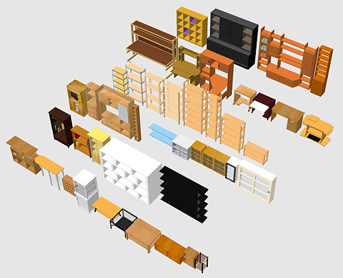

If you want to try with more shelf units or furniture containing shelves, I already defined the shelfElevations or shelfBoxes property of the 44 ones found in the Contributors library that you may try with the Beta version 1.9.1 of furniture libraries.

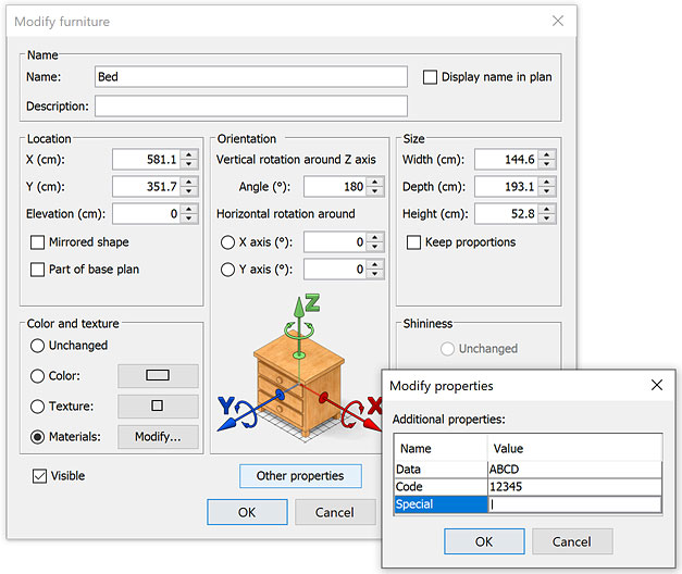

• It's possible to define additional furniture properties to handle customized user data associated to the objects added to your home. This data may be displayed in the furniture list, modified in the furniture dialog box and/or exported to CSV.
For the moment, there's no user interface to define these properties and they must be cited in the System property named "com.eteks.sweethome3d.additionalFurnitureProperties", each property being separated from others with a coma like in "Data, Code, Special" which describes 3 new properties. Setting this System property can be done with the -D Java option in a SweetHome3D.l4j.ini file stored in the same folder as SweetHome3D.exe under Windows, in SweetHome3D.cfg configuration file found in Sweet Home 3D.app folder under macOS or by modifying java command line in Sweet Home 3D script under Linux.
The additional properties can also be set from plug-ins using the methods getFurnitureAdditionalProperties / setFurnitureAdditionalProperties added to Home class.
The added furniture properties will appear in the Furniture > Sort by and Furniture > Display column menus to let you display them in the furniture list like in the following screenshot, which handles the three columns in SweetHome3D.l4j.ini file with the line:
-Dcom.eteks.sweethome3d.additionalFurnitureProperties="Data, Code, Special"
You will be also able to modify the property values for each piece of furniture thanks to the new Other properties button added at the bottom of the Modify furniture dialog box, when such properties are defined.
As the value of additional properties set in a furniture library will be copied to a new home object when it's added to the plan from version 7.2, you may give the initial value of these properties in a SH3F file.
By default, additional properties and their values are exported to CSV files too.
But com.eteks.sweethome3d.additionalFurnitureProperties System property can also describe the type of each property and whether it should be displayable in the furniture list, modifiable in furniture modification pane and exportable to a CSV file. It can also describe the label of the property which should be displayed in the user interface.
To use these features, a property must be followed by the following information ( | symbol means or):
:ANY | STRING | BOOLEAN | INTEGER | NUMBER | PRICE | LENGTH | PERCENTAGE | DATE | CONTENT
displayable=true | false
modifiable=true | false
exportable=true | false
displayedName=Text label
For example, if com.eteks.sweethome3d.additionalFurnitureProperties System property is equal to:
"AltCode:INTEGER modifiable=false displayedName=Alt. code"
the program will handle an additional property named AltCode which can be displayed in the furniture list and exported to CSV, but you won't have the ability to modify it. In the furniture list and in the Furniture > Sort by and Furniture > Display column menus, it will appear as Alt. code.
If com.eteks.sweethome3d.additionalFurnitureProperties System property is equal to:
"QR:CONTENT displayedName=QR Code, Rebate: PERCENTAGE"
the program will handle the two additional properties QR and Rebate. QR code will handle an image (type = CONTENT) and Rebate a percentage that you will be able to modify. QR will appear in the user interface as QR Code (note that displayedName must appear as the last information before the coma because it may contain some spaces) but won't be exported to CSV (CSV can include only text).
By default, the type of a furniture property is ANY, i.e. it can handle any type of value. However, when the furniture list is sorted on a property of type ANY, values containing numbers will be sorted in correct order (meaning 100 will appear after 12 in ascending order).
As shown in the following screenshot, the Value column of Modify properties dialog box will show:
1. a Modify button with the selected image for a type equal to CONTENT,
2. a check box for BOOLEAN type,
3. and a formatted text for the INTEGER, NUMBER, PRICE, LENGTH, PERCENTAGE and DATE types.
Selecting the later types will also force the user to enter the correct information.
Additional content values will be saved in the .SH3D file, values of type LENGTH will be saved in centimeter and values of type DATE will be saved in the format yyyy-MM-dd (for example, 2023-05-20).

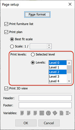

- Support for multi level printing: when you home contains more than a level, a new section Print levels appears in the page setup dialog box to let you choose the levels you want to print during the same printing session.
