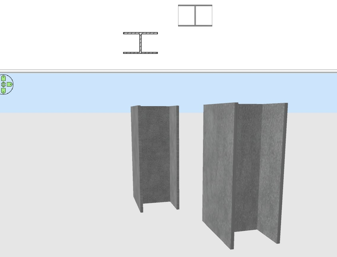

Bonjour Bob.
Un simple exemple pour un fer en H.
A partir de murs aux dimensions que vous souhaitez (à gauche sur l'image), vous pouvez exporter l'ensemble au format .OBJ puis le ré importer en tant que "meuble" (à droite sur l'image).
Et modifier les dimensions ainsi que les textures.
Vous pouvez ainsi créer toutes les sections que vous souhaitez.

I would use boxes instead of walls.
Look at this image (and the image from captaincook):
First notice the diagonal texturing on the center part. That is not only a problem with walls but also with vertically placed boxes as you can see in the top examples of both walls and boxes.
The bottom right beam is as the result should be: no diagonal lines in the center part and overall correct texturing. That result is created with two horizontal boxes that were textured and exported as 'partA'. Then the center part was created with a box but oriented horizontaly (in the 2D pane) like the first two boxes, then textured and exported as partB.
Both partA and PartB were imported and partB rotated and placed at the correct position in partA. Both together were then exported and imported as 'Beam'.
The same could have been done with walls: texture the center part with a horizontally placed wall and export/import separately from the other two walls. Then combine like I did with the boxes.
The diagonal texture problem is caused by the Texture Vertices in the obj file (vt lines). By texturing and exporting a part when it is positioned horizontally the texture vertices are calculated correctly and don't cause diagonal lines.
This means that with either walls or boxes the same result can be achieved. But...
Look at the text on the right in the image. The numbers should say enough. The example created with boxes is smaller. With 10 beams you won't notice the difference but when you create big construction project the number of beams increases rapidly andd with that the number of vertices and faces that must be rendered. Then count other parts that are created with either walls or boxes and the difference in numbers increases even more.
I could have made the left and right faces of the center box invisible (you can't see them) to reduce the number of faces with 2 but for this example I left them in.
There are a few more tricks to optimize models, like merging all groups with the same material, but you need to use Blender for that.
I spend most of last year re-designing all my custom created furniture to decrease the shown numbers because my large projects started to get incredibly slow and became even impossible to show in the html-export. I got a lot of experience in decreasing object sizes and I'm still not even halfway with all I have to re-design.
The thing is: I managed to reduce the size of most models to only half or one third of what they were before. That's a huge difference. Do it right from the start so you don't have to spend many hours re-designing when you run into size problems like I did.

Bonjour Keet.
Pour revenir sur le problème des textures apparaissant en diagonale dont vous parlez dans votre message, j'ai constaté qu'en appliquant ces textures sur les 3 murs avant de convertir l'ensemble en objet, le problème n'existait plus. Initialement, j'avais appliqué la texture après avoir crée l'objet.
L'autre avantage de concevoir la pièce finale à partir de murs est qu'on peut, si besoin, courber les murs.
Par contre effectivement vous avez raison, l'objet crée à partir de murs pèse plus lourd en octets que celui crée avec des boites.
Bon dimanche.

@captaincook
Je n'ai peut-être pas été assez clair dans ma réponse : appliquez des textures aux différentes parties avant de les exporter. C'est une bonne chose que vous l'ayez signalé pour les autres utilisateurs.
Il est vrai que la conception avec des murs présente certains avantages, notamment l'arrondi que vous avez mentionné. J'ai créé un siège pour des tribunes de stade en utilisant des murs uniquement en raison de la possibilité d'arrondir et d'incliner deux moitiés pour donner un peu d'inclinaison au haut du dossier. D'ailleurs, l'"arrondi" n'est rien d'autre que l'inclinaison de plusieurs sections d'un mur pour simuler un arrondi. Le problème est que le point de jonction entre deux sections présente souvent des faces de part et d'autre de la jonction. Comme les murs fonctionnent avec la moitié du côté de l'extrémité pour chaque côté du mur, cela fait 8 faces à l'intérieur du mur par connexion que vous ne voyez pas.
Après avoir construit un stand avec des centaines de sièges, j'ai importé les sièges dans Blender et j'ai supprimé toutes les faces "à l'intérieur" des murs et j'ai remplacé les faces doubles du côté de l'extrémité par des faces simples. J'ai également supprimé toutes les autres faces invisibles. Le résultat est moins de la moitié de la taille précédente. Un stade complet comporte des milliers de sièges de ce type, de sorte que chaque octet économisé est important.
Un jour, je découvrirai comment définir une véritable courbe, car les spécifications OBJ le permettent. Il faudra alors voir ce que cela donne au niveau du temps de rendu. Je m'attends à ce que ce soit plus rapide que le rendu de plusieurs sections d'un arrondi, mais je n'en suis pas certain.

Oui Keet, on parle bien de la même chose et on est bien du même avis smile
Et concernant le "poids" différent selon la méthode appliquée, j'ai fait la comparaison avec 20 pièces en H.
Le fichier avec les H réalisés à partir de murs faisait 2 fois plus d'octets que celui avec des H réalisés avec les boites.
