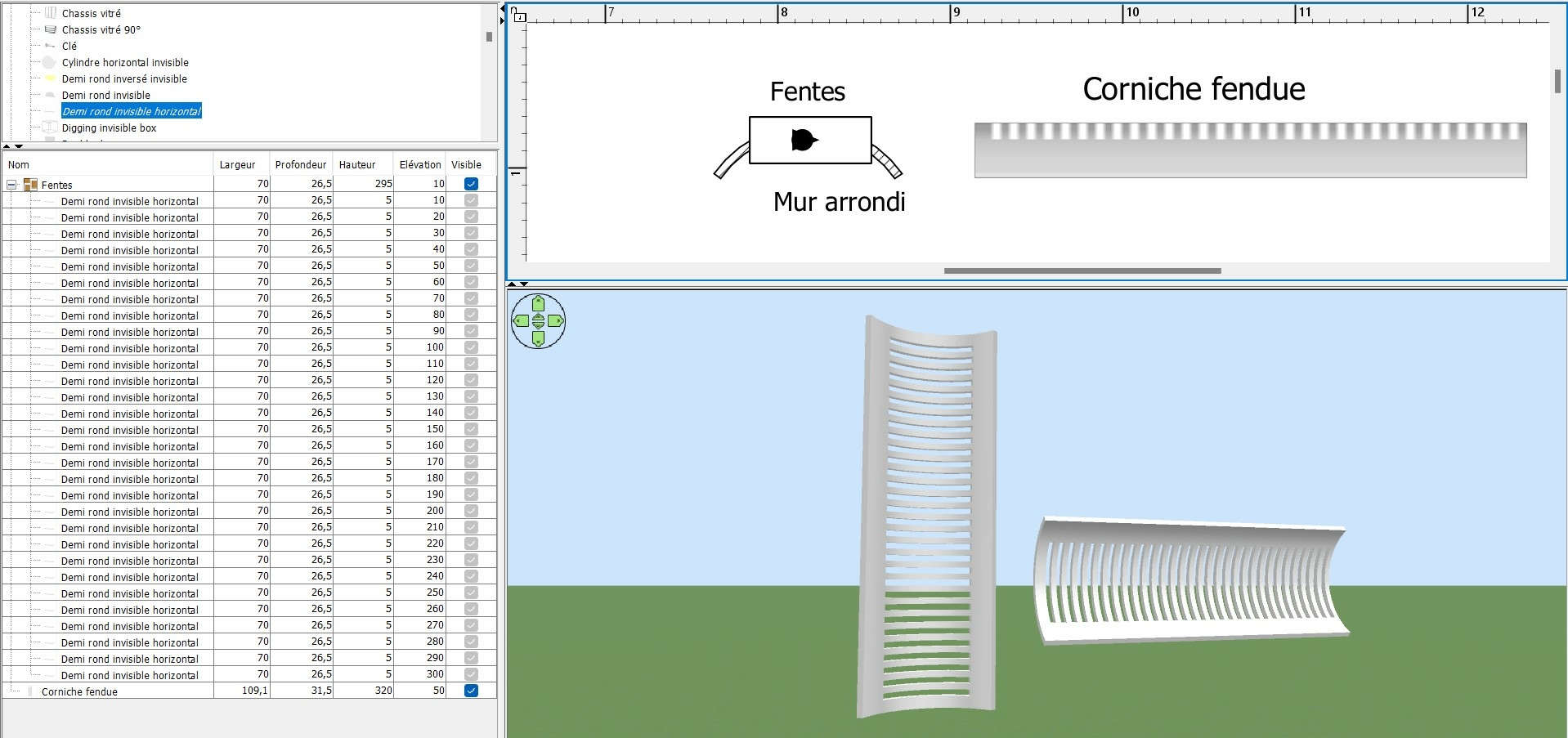

confused Holes with curves in curved surfaces
Hi. I want to make ventricles on a plaster semicircular cornice. As in the photo. Does anyone know how to make such holes in SH3D? So far, I've only got rectangular ones, but I need to do them with rounded ends.

captaincook
Joined: Oct 20, 2017
Post Count: 263
Re: Holes with curves in curved surfaces
Bon, j'ai ajouté des petites pièces taillées sur mesure (en rouge sur la pièce à droite) pour obtenir le résultat final à gauche.

Post Count: 1248
Very clever. Using a smaller filler piece for the roundings. That's another way for GaudiGalopin3324 to achieve what he wants in Sweet Home 3D.

GaudiGalopin3324
Russia
Joined: Aug 13, 2022
Post Count: 481
I did it like this. I built a wall of five parts, left two short parts straight and carefully bent the other three parts into an arc. Then he pierced it with round and rectangular windows. The main thing here is to turn off the magnet. The round window (purple) fits well into the wall only in one single position - strictly perpendicular. You need to catch this short moment of window movement and release your finger from the mouse. And then the window moves to the right place of the straight wall. The other half of the window in the curved wall cuts a rectangular hole next to it, but it doesn't matter anymore. With two rectangular windows (green), you can add a gap in the curved wall between short straight sections. Then you need to save it to OBJ, rotate it properly, make the windows invisible, and save it back to OBJ. It turns out a section with a slit as in the photo. These sections can be combined into a group of the desired size. And a cornice without cracks is a wall without windows, also a separate model in OBJ. everything is combined into a single composition. Interestingly, when scaling different models of this cornice, for some reason, slightly different sizes are obtained, I fixed everything to single digits manually.
