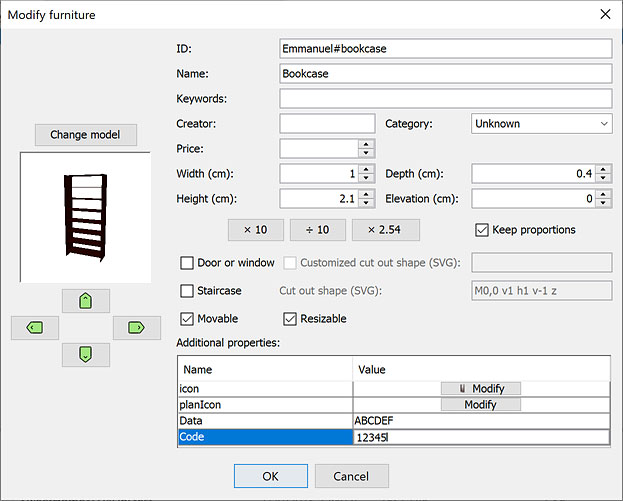

The version 2.0 of Furniture Library Editor is on its way, and I would like you to test a Beta version before releasing it.
Its preferences pane was updated to let you add your own typed properties, and set whether each property should be modifiable and displayed in the furniture list of the editor. The list of furniture properties contain also the ones known in Sweet Home 3D like light properties and door/window properties, to let you choose whether you want to modify them or not in the modification dialog box of each piece of furniture.
Modifiable properties then appear in the furniture modification dialog box to let you set their values. Some known properties like price or resizable will appear as additional fields or check boxes, and other properties will appear in the new Additional properties table:
The properties with an Image type, like icon and planIcon in the previous screenshot, will be displayed as a button in their Value column to let you choose the image file of your choice.
When the icon property is made modifiable in the preferences panel, you'll be able to choose an image with this button instead of a screenshot of the 3D preview.
The Editor will check whether values entered in the table for Sweet Home 3D known properties are valid, for example if the value of door sashes properties doorOrWindowSashXAxis, doorOrWindowSashYAxis, doorOrWindowSashWidth, doorOrWindowSashStartAngle and doorOrWindowSashEndAngle each contain 2 numbers if you want to define 2 sashes.
Finally, the value of the following properties must contains lengths expressed in the current unit that the Editor will convert in centimeter in the SH3F file:
doorOrWindowWallThickness
doorOrWindowWallDistance
lightSourceX
lightSourceY
lightSourceZ
lightSourceDiameter
dropOnTopElevation
shelfElevations
shelfBoxes
Hope you'll like it smile
