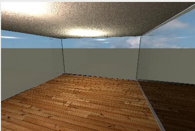

1 - When I open your file, I see that in your room you only have two small lamps of which I'm not sure if they give any light.
2 - The only light that is active, is the ceiling light. One problem is that 1 ceiling light cannot give sufficient light for a 30 m2 room.
3 - I added five 50x50x50 cm halogen lights (elevation 200 cms, set a 50 degree angles) and I checked Turn on lamp lights in the Advance Render plug-in. The result you can see below.
4 - The walls are all very blue. I checked the ceiling, saw that it was blue, and changed it to white. The walls still remained blue. I then deleted the floor and ceiling and saw that you used a blue sky as texture for the floor. I changed the floor texture and the sky texture, and made a new render. Still the wall remained blue. Investigating further I discovered that the chimney walls are transparent. Strange?! I deleted both walls and drew them again, giving them approx. the same colour. And? Even stranger: they're still transparent. The two colours blue that you see are the ground and sky. Somewhere in between I changed all wall heights, so that now they are 250 cm high, and after that I put new floor and ceiling.
5 - Because I don't like riddles, I decided to deleted almost everything and see what happens when I have an empty room. Here it is.
To make a long story short: it is a riddle, it remains a riddle. I can't solve the transparency of the walls. I suspect <?> that the file is somehow corrupted, but I'm not sure.

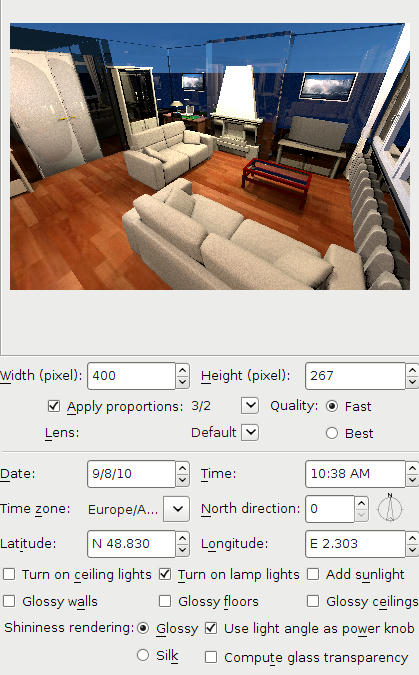

Like Hansmex, I don't like a mystery either, so I downloaded your file Rob123, and noticed your wall transparency is slightly moved. If you move the wall transparency slider all the way to the left, You will get a good solid wall. You are getting the glass look because the renderer thinks of the walls as transparent. Here is the render I got...
I see your file is in what I believe is french, so if I haven't explained clearly enough, maybe someone can translate this into french for you...
BTW, Very nicely done home, it looks excellent.

Maybe db4tech has any ideas? He programmed the advanced render plug-in.
Aw Hans, as much as I wish that was true, Emmanuel is the programmer! smile
Thank you though!
I wonder why the doors (on the left) are rendering with an unusual shiny patch in the middle?
Good work trying to find the walls solution, very thorough!
db4tech
Good catch whippet on finding the solution, not sure I would have noticed the slider since it was only slightly moved! smile
I never realised the walls rendered as transparent, if the transparency slider was changed, I thought that feature was purely for OpenGL 3D, to assist in positioning difficult items close to walls.
