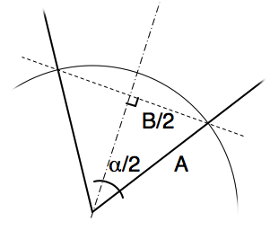

I'm trying to create a plan for an old room in which the corners are not at 90 degrees.
I had hoped that I could just enter the wall lengths and then drag them around until the room was right in the program - but when you drag a wall it changes the length, so that doesn't work.
Has anyone got any ideas on how I can measure the angles of my room so that I can enter them in the program?
Or, a way of using the program so that I don't have to measure the angles?

1 - Use a bevel protractor to directly measure the angle of your corners. You can make one yourself using a regular protractor and a ruler. 2 - Using paper or cardboard, make molds of every corner. Then use a protractor to measure the angle. 3 - Locate building plans and use them as a background image.
