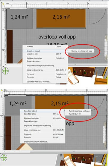

I created a room (surface) in my home but i can't select it to delete it. when i trie to select the surface, my walls are selected. i tried with the TAB button but that don't work. thanks for your help.

hello , my problem was not the locking of objects. after that i tried the "select all" and then "shift and select" option but that doesn't work. my problem is that i can't select a surface that is INSIDE a room. when i trie to select it is always the wall of the room that is selected. how do i attach my workfile (sh3d) in this reply?

After a time of holiday in Copenhagen i tried again to select my surface and there it was!!! The upload via mediafire didn't work but i managed to create a picture to show what's happening: i tried to select the surface of 1,24m² by clicking in it, but it was always the big room (walls) that was selected. Now i tried to select with a right mouseclick but that didn't worked when i pointed the mouse in the room somewhere. Finally i pointed the mouse in the surface of 1,24m² and now i could select between different surfaces!. See my picture to know what i mean because i am dutch and my english is not super... thanks to everyone who tried to help!

1. I reproduce your issue. I suppose you draw first the smaller rooms and then the largest room on top of the other two. In this case you will can select only the big one. If you need such surfaces draw it order from the larger to smaller to be able select them individually. 2. The tutorial for posting file trow mediafire.com must be updated because ther is few diferent steeps. Dorin

I think Dorin is right The smaller room/floor is lowwer. So you can't slect it. Drag select wall, room/floor, furniture.. which including small room. Holding keyboardShift+click the wall and other(not small room) to deselect from selection.
