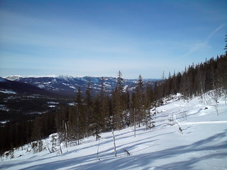

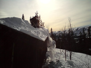

Follow-up from thread 5778 and moving here: Challenge is a small cabin > 5km from grid and no motorised access (too steep, wild). It works well already with wood, candles and water from a stream (if not exactly family friendly). To increase modern comforts, planning is now:

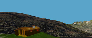

So, if anyone has any experience with such or other alternative technologies, please share. SH3D is a brilliant canvas, but ideas for optimal solutions would be welcome.
Challenge
Much, much steeper than it looks, beyond snowmobiles
SH3D planning, early overview rendering
