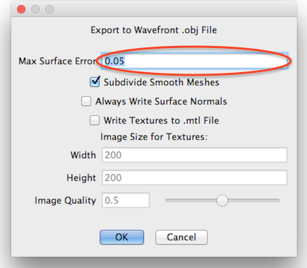

Another question: Is there any way to compress size of objs? I created a lamp and now the obj is about 38 MB which slows down the house. Any ideas are so so appreciated.

Regarding the custom lamp, I used a combination of cylinders and models in Art of Illusion and SweetHome itself. I've attached a link to that as well.

To make a lamp design that "weighs" 28 MB seems like overkill.
Models like this will slow down the performance of SH3D to a level that doesn't feel comfortable anymore.

If you designed your model with Art of Illusion, you should pay attention to the value in the Max Surface Error field when you select Export > Wavefront menu item:
This value is used to approximate round surfaces to triangles and rectangles that are the only shapes supported by OBJ format. If you use a too small value (like you probably did), this will end up to the creation many super small triangles in a big OBJ file, with no visual benefit.
Try a bigger value until you get a correct result with smooth enough surfaces.
