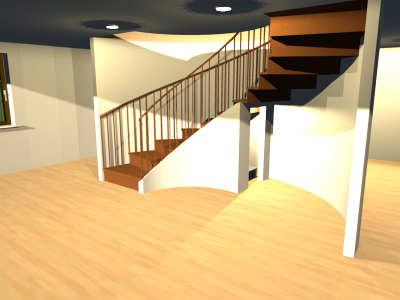

Some changes to the semicircular staircase in library as it did not texture right and lacked handrail on one side. Also it was a bit too large for domestic use. Model has planIcon added. Some do not like them, but some apparently find them useful. This planIcon is deliberately made semi-transparent so the 2D plan will show furniture under the stairs. But if someone wants to edit, model and supplementary files in SF 3D models 329.
As the cut-out (staircaseCutOutShape#xx =m 0,1 a .5,1 0 0 1 1,0 l -0.25,0 a .25,.5 0 0 0 -.5,0 z) is a bit tricky in non-square co-ordinate systems, the SVG files are included with co-ordinate system for browser viewing. The path should be possible to edit with Inkscape (use the XML editor, to view the d-value), even if it may be a bit hard to control. (Inkscape likes to change Elliptical Arcs to Bézier curves and may convert to a mix between relative and absolute paths and many decimals - unless settings are changed. And even so, the result can be pretty frustrating).
SH3D file: moonstair.sh3d
Model: moon_staircase2.zip
