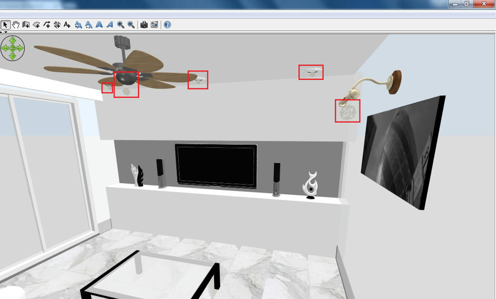

3,4: Here is the image so that you can see it clearly
About the transparency, at this time, Sh3d doesn’t support us to change the material of object to transparency or glass. I hope SH3D will soon have this feature soon. Therefore, I just place the light sources in front of the light fixtures (the image).
In brief, your questions are also my questions. I hope SH3D can let us add glass material to furniture and modify light source to other shapes, not only sphere.
