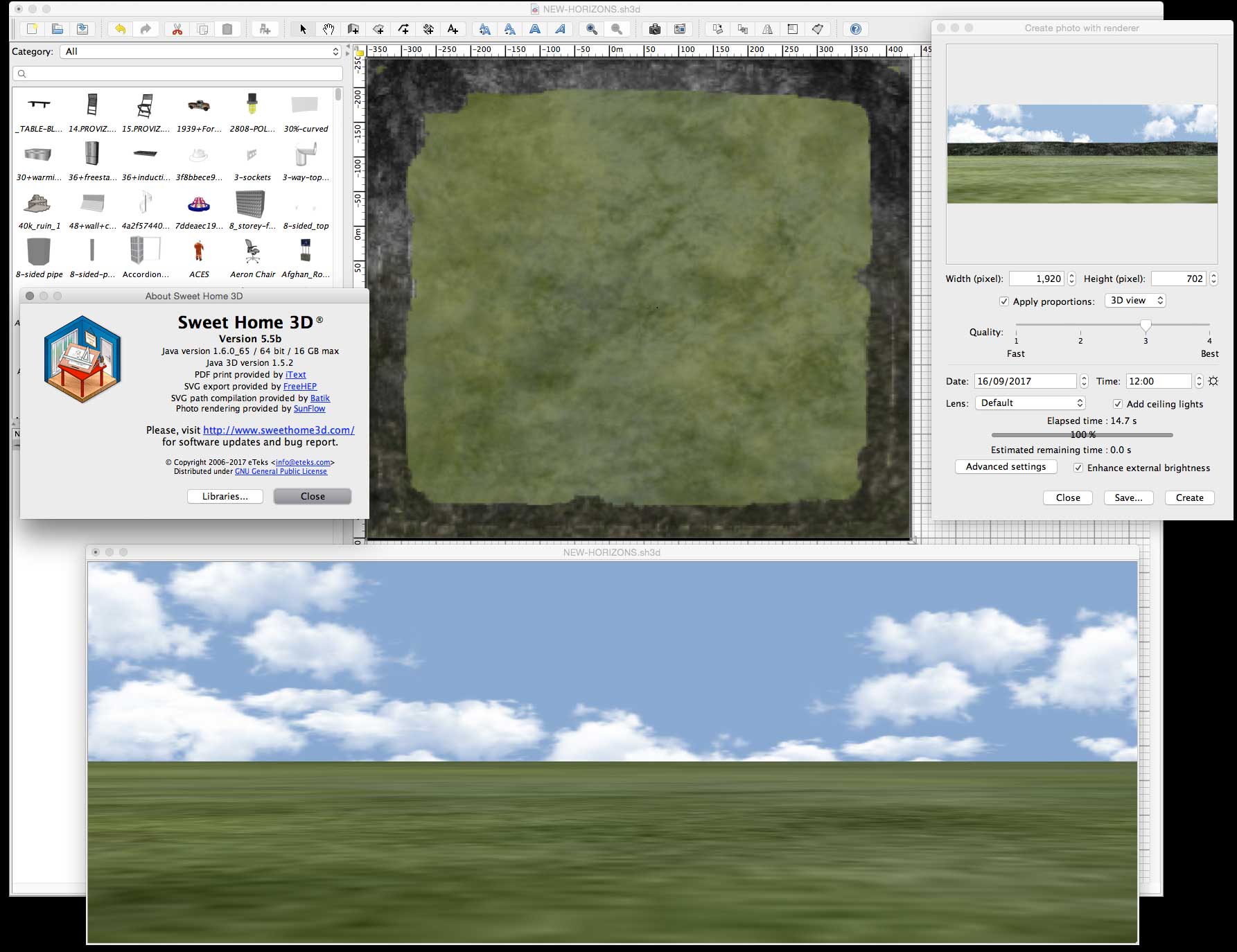

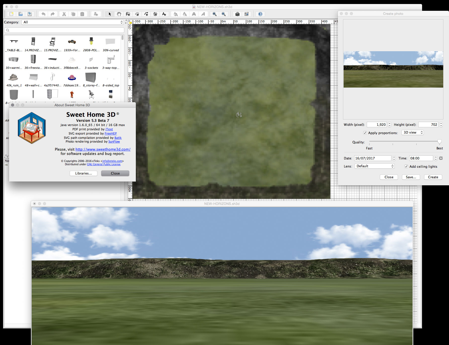

V5.3
V5.5b
As you can see from the second screenshot, we can no longer preview the placement and size of distant objects, such a horizon or a distant city, or other elements that will be quite visible in Q3 and Q4.

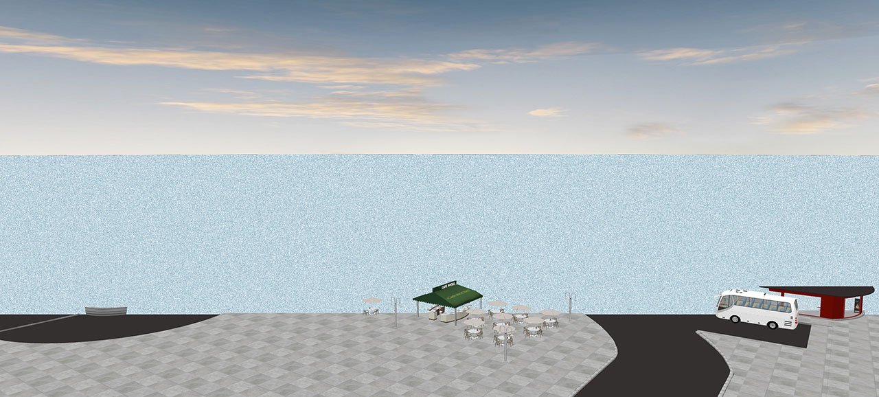

A preview in v5.3 can look like this:
In v5.7, however, a preview will look like this:
which makes it somewhat challenging to compose a nice picture, having to more or less guess what my composition will look like.

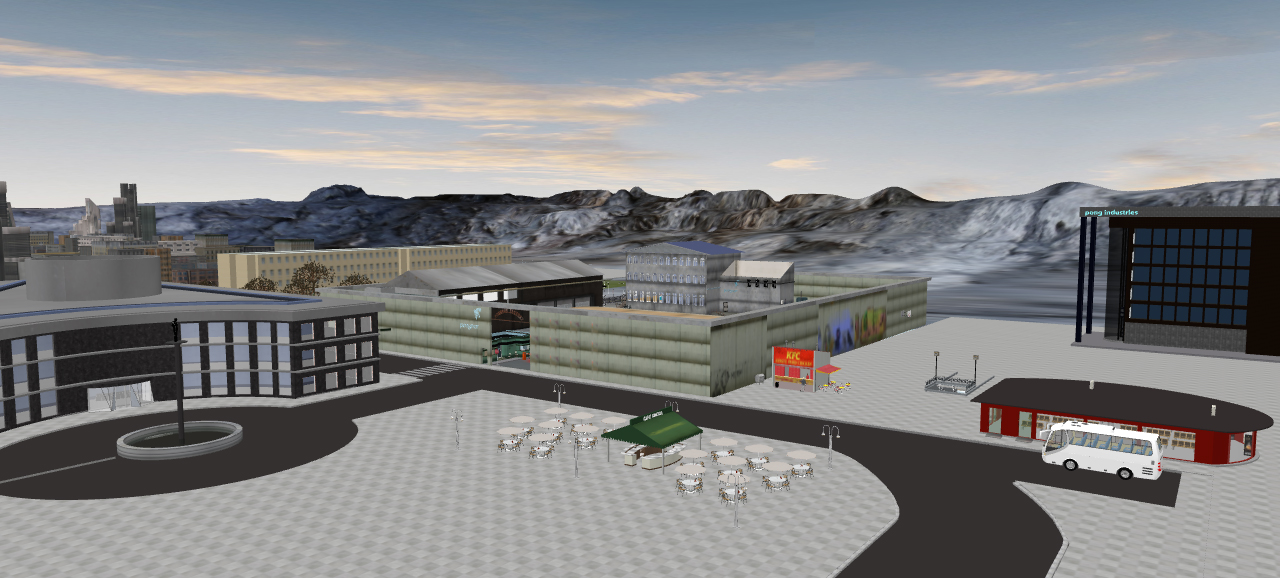

Of course I can still use 5.3 it to compose my pictures, and then copy the coordinates of the virtual visitor manually from 5.3 to 5.7,
and render it with the correct texturing:
But it's a time consuming process going back and forth, opening heavy project files.
