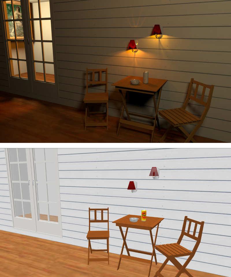

This is far from perfect, but I think it's the best I can do:
And it really doesn't take long to render:
This time rendered on an iMAC quad-core i5.
Here is the project file ( not zipped):
Lampetter-6.sh3d
And here is the model (only 231 kb, – and that IS small.. or?):
Lampette-01.3ds
The model is based on a photograph of my grandmothers lampette.
Have a nice weekend. smile
cec

Re: A major challenge?
@cec
Well, your rendering is pretty close to perfect in my view. But I could not help myself and try the same with very simplified models/textures to speed it up. A similar room,
- with a replica of Cec' lamp shrunk to 14 KB including texture (but much rougher, of course),
- simpler chair and table, also a fraction of the size,
- same with other textures / models,
- swapped the wine/glass with drinking beer from a can (seemed more appropriate given the lack of finesse).
Beauty and the beast if you like. Now, clearly Cec' version is far better in all sorts of ways. But, there is something to be said for the rough approach too - the total plan is less than 10% the size of the pretty one. Which means it is faster and easier to work with on a slower machine. The plan is (for me) sufficient to see what I want to do in real life.
As for adding light-sources in the lamp model properties, that still annoys me. Could not get that right, but a few lessons learnt:
  • getting an effect close to Cec is possible, but not without cheating' using extra light-sources inside and outside the model,
  • placing small lights around the bulb in the model properties is better, but very hard to get right. This is as far as I got:

  • even if light colour is tuned almost to black, the light gets way too bright in the model(probably doing something wrong here)
  • several (three) light-sources are better than one, but also increases the total output of model light.
  • I did not check rendering times, the computer I am using now, is too slow for many takes. Still, the simplified model was rendered without too much delay.
While difficult to get right, using several light sources in the model, is probably the right way to go. Should I ever get it right, I will let you know... smile ok
Put the models and a demo in SF 3d models 400 in case someone wants to improve or tell me a better way.

Funny what happens during week-end shopping. The stupid mistake in above example dawned on me over a display of avocados: The Y-axis values are calculated from the wrong side of the model, so the light-sources are placed outside the lamp-shade, hence the wrong reflection. Also, the lampshade needs a different material on the inside.
Fixing the co-ordinates, and setting the inside of the lampshade to a material transparency to an .mtl value of d 0.5, the result suddenly became much closer to what I wanted.
Yes, I know, certainly nowhere near perfect, but the lamp model is now getting closer to usable. The remaining issues should be fixable.
Thanks a lot to cec for steering me in the right direction. Time for some Saturday cooking and a ... well, can ... of something. Updated/corrected SF page .
New plan (model has built in light): lampettefix.sh3d
New model (obj. without light-sourcs): small_lamp_3.zip
