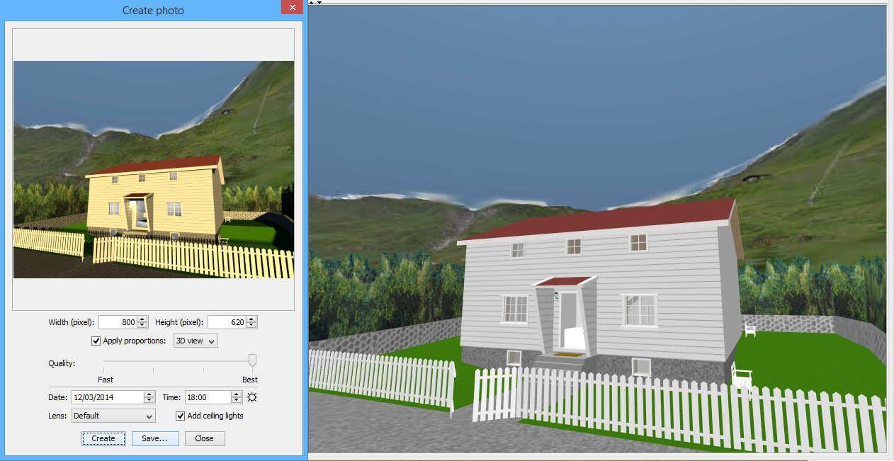

The models will not blend in properly, like you can see when looking more closely at the 5th image in my last post. Even if I did my best to colour-correct the highlights and match the shadows, it's still obvious that the picture is a combination of two different images.

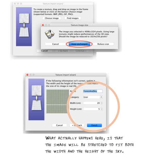

However, I have looked at the blog post you recommended, and feel I need to comment on the methods that are suggested.
Using a non-square image will not give the best result, as the sky is actually projected from a square image.
A rectangular image is automatically stretched to fit a square when it is applied to the sky, and it will appear oversized and loose a portion of it's original resolution. A 4096X1024 image will lose 3/4 of its resolution.

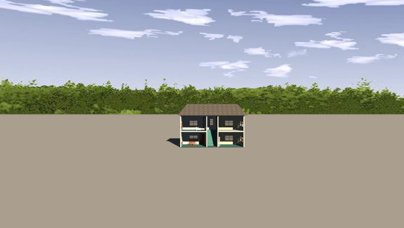

Applying a rectangular 4096x1024 image will look like this:
Fitting the image to a square matrix is a better way to apply an image to the sky. Then it will keep most of it's qualities:
And it will render like this:

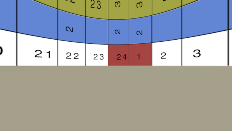

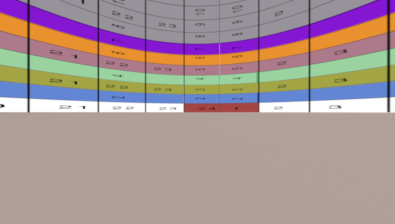

But then there's the distortion that we have to adjust for:
Now it renders like this:

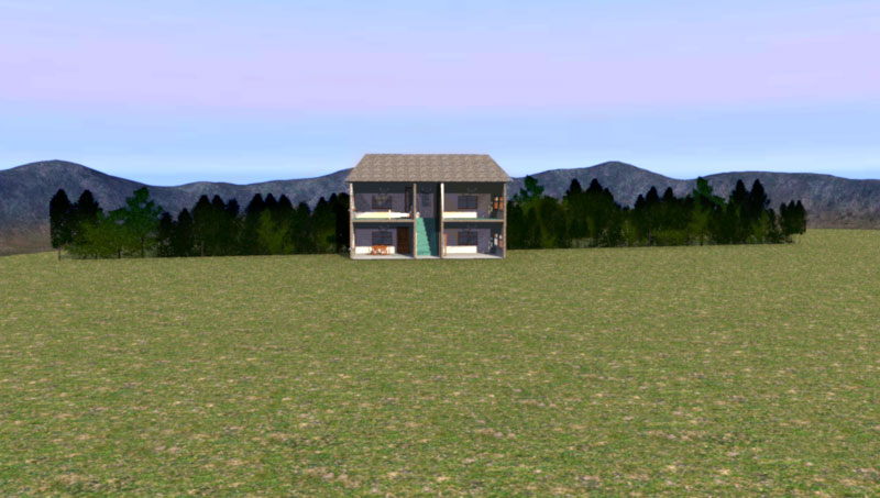

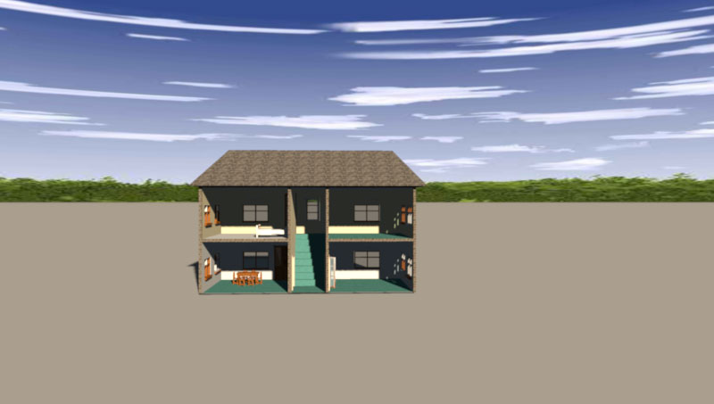

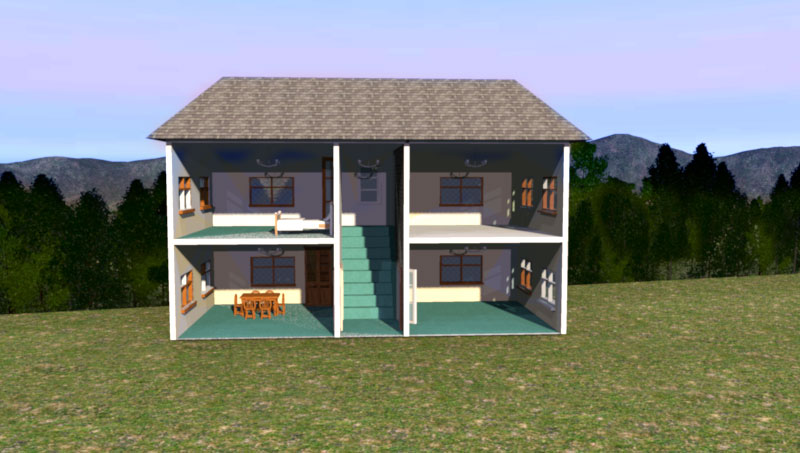

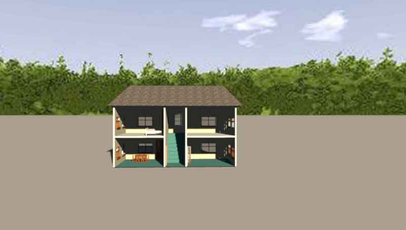

Here is a close camera position:
And moving the camera back, here is a far cameraposition, with the same field of view:
The size of the horizon and the trees will follow the camera movement.

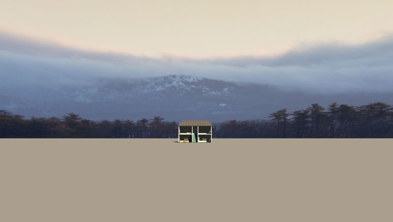

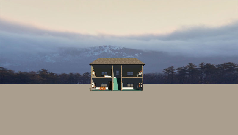

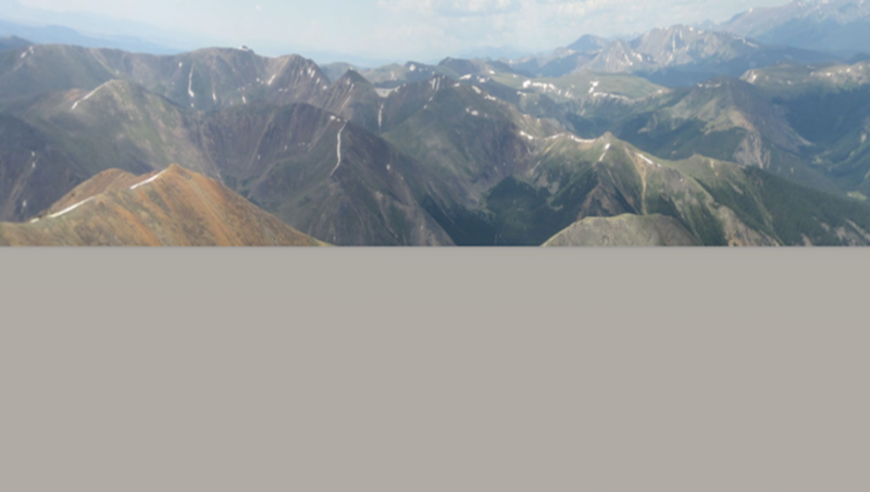

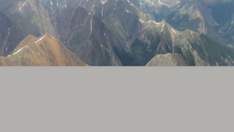

And then I have added a sky with mountains:
One-by-four-rectangle.
Image 4096X1024
One-by-two-rectangle.
Image 4096X2048 - sky applied to the lower half. Not adjusted for distortion
Square.
Image 4096X4096 - sky applied to the lower quarter. Not adjusted for distortion.
Any views on what comes out best?

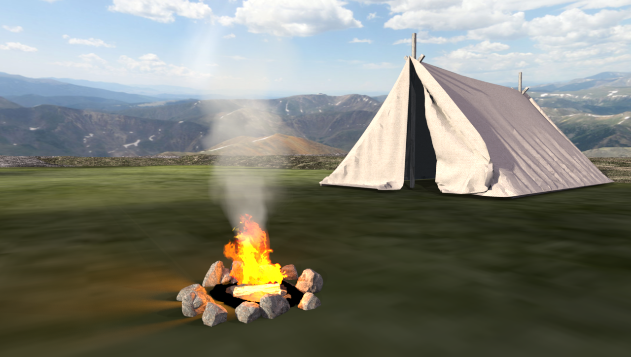

Tent and campfire Sky adjusted slightly for distortion

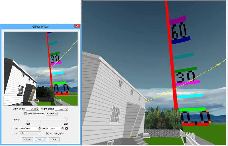

By the way, in my test texture I have somehow put 10 and not 9 lines to represent the 90° to zenith. While it still illustrates the distortion, it needs adjustment if anyone wants to use it for measuring horizon objects such as a high mountain.
As most smartphones have compass/plumb/level functions (usually a separate app is needed), the angle to the mountaintop can be calculated quite easily as can the alignment of the background texture (starts to the right in the 2D plan, East if compass is due North). That way, it is possible to create a surprisingly accurate horizon around the model which can be completed with other objects close to the building.
But I need to emphasise - that Cec' approach with extensive use of 3D objects is much better for the beautiful renderings where the sun and shades caress the landscape. The rougher texture-sky-treeline approach has a more practical merit: When I work in the 2D plan I want a simple, instant way for the 3D window to display the view around the building. For instance, will it be possible to see mountain X through window Y from my favourite chair.
A rough technique for real life projects where rendering is not the objective, but the point is getting the construction details right through planning with various tools (as mentioned in threads 6162 and 5953).

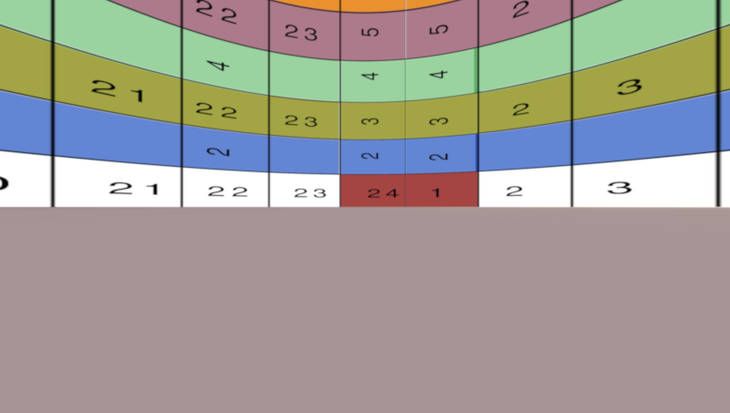

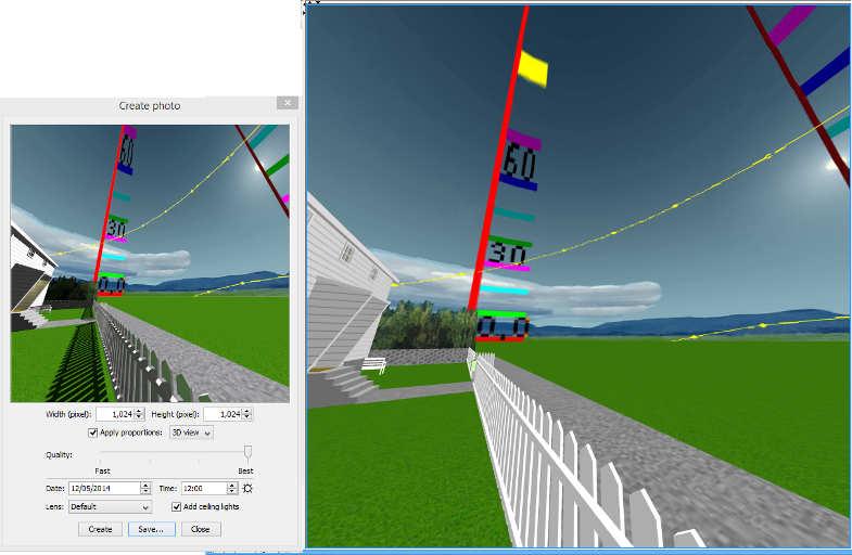

Just to explain the curiosity about how the sky texture is aligned. In this example, with absolutely no rendering ambitions, the aim is to visualize light on a building. Sun path at winter and summer solstice on the background. 2048×512 canvas/texture, degrees and sun path are relatively correct on canvas (the rest of the rest of the sky-texture is based on a couple of random + gradient sky and noon/May Sun).
See the 3D viewer for the full picture. The rendered photo seems more correct than the 3D view - but still off. Would it be useful if celestial objects were correctly placed on the sky texture? Or, more likely, is there a reason for this projection that I am missing? More a question of curiosity than anything else.

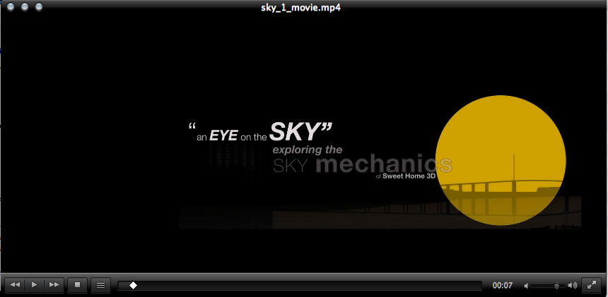

I actually made a video a year ago, showing how to improve and handle
sky texturing. But I never got around to finishing it with sound and VO.
But it kinda works without.
In case someone wants to see it:
Lef-click to play in a new window or right-cl...e target to DOWNLOAD 16MB
