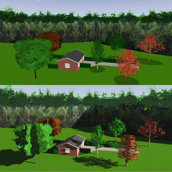

Put new link in another thread than intended (7742). In SF 3D models 261 an attempt at a simpler tree (zips to 352 kB, 1071kB uncompressed). A birch, but just apply different trunk texture to change. Should be possible to bring the size further down and fix some details. A very simple tree, work in progress, next to it. ok

Hmmm, Puybaret's simplification of (tree_birch) is beyond what I can manage. But the result is fantastic, a proper tree to use with SH3D on slow computers. I did manage one smaller (tree_generic), but also with less detail.
As a compromise for those who dread bloated files and sluggish drawing, this could work. Beware that the rendering will also be inferior to much of what is found in the gallery such as Cec' shrubbery.
As SH3D only stores one copy of a model used several times, using just one of the trees and play with sizes and colours can make for a nice little forest without increasing the sh3d file size - in fact, the models will let you make a forest without adding more than a couple of hundred kB to a compressed .sh3d file. See example file trees_misc_simple.sh3d.

Thanks a lot to Puybaret for taking the time to explain how this could be done. Models updated accordingly (I hope) in SF 3D models 261 . Even if the simplest one at 235 kB / 93 kB compressed may have shortcomings, it is pretty nice to get an entire forest into a 140 kB .sh3d file. ok
Test video: tree_grove_sml.mp4.
Test image:
