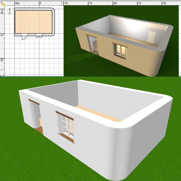

Can you draw a convex curve on the external surface of walls. I am planning a straw bale house, the walls will be 500mm thick and every corner, window or door reveal will be curved, can I do this? The radius of the curve will be approx 200mm I think.

Hoping I understand your question:
For a 'normal' 0°-90° corner, you could use a short wall angled 45° between the two walls and set the Arc extent to 90°. Ending a wall with Ctrl-right-click lets you set the Arc extent directly for your corner walls.
Getting the same effect on doors/windows is a bit harder as the cutout will be a right angle. However, I suppose you could double walls and apply the trick above for every opening. But that is cumbersome and hard to edit later.
A better idea is probably create your own door/window models and build the curve into the model itself. That way you can move the window/door around easily in one thick wall.

Not easy to imagine...
Can you send us a drawing even simply done or an example found on the web ?

Possibly something like this (in SF 3D models 452)?
newin_curve_publ.sh3d

Wow thats awesome,
that's exactly how I want them. So whats the best way to learn how to model, house plan drawing is not new to me, but programs I have used in the past I have just used the programs pre sets, cos I didnt have to be thourough it was just concept. But this I want to actually draw the architectural drawing to AU standards and then print them for submission. I am hoping I can do that in SW3d.

Straw bale...
Very interesting, please keep sharing. Projects like yours and thread,5643 provide very useful information.
..draw the architectural drawing to AU standards and then print them for submission. I am hoping I can do that in SW3d... ..do the final 2d plans in an auto cad...
I see no reason why you should not be able to do almost everything with SH3D. At least here, I have yet to find legal requirements that cannot be satisfied with an accurate SH3D drawing (with the possible exception of facade drawings ). For finalising the 2D plan, SVG export and Inkscape will get you a long way.
..the best way to learn how to model...
Model itself is quite simple, mostly squares and can be done with pretty much any software. Even SH3D. Guess the most commonly used free sw would be Sketchup and Blender. The latter a bit daunting but very powerful. Both have instruction videos online that proved very helpful. Art of Illusion and Wings are other alternatives (and 3D builder / Paint 3D in new Win 10 updates), but I never really really put any effort into learning them.
The window model posted is true to standard sizes here. Window sold as 1000×1200mm is actually 985×1185mm to allow for adjustments and insulation. This can be important when using SH3D for actual construction and submission of drawings. The other elements are literally window dressing - like your curved walls (or weatherboards/windowsills and other stuff in the original sent by e-mail). All these elements can be set to invisible (or changed) in the Modify furniture / Modify colours dialogue.
Long and short of it is that creating basic models need not be difficult or take long (with a bit of practice). And the basics will work directly, like SH3D aligning model to wall and create the cutout. But it is also possible to put some extra post production into a model to optimise for SH3D. And not least, shrink the model to reduce file size and increase SH3D speed.
