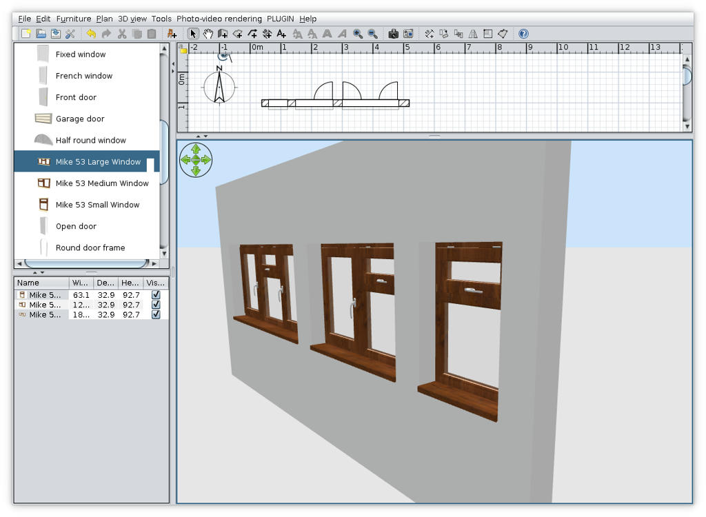

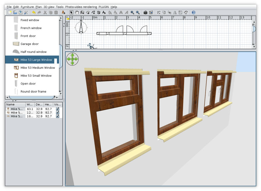

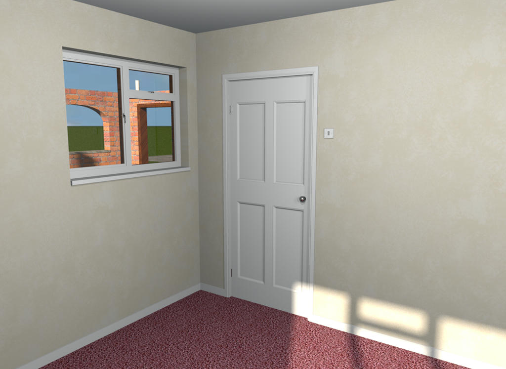

Thank you again for all your help Dorin.
I cannot imagine me trying to learn other software nor can i master these mtl files or give plan view the openings, so i will stay with what i have, i will however try to find a different handle for them the size (weight) grows about 10x by using the ones i have.
Door without handle <300
Door with handle >800
large window without handles <400
With 3 handles > 1800
Door and window
Thank you again

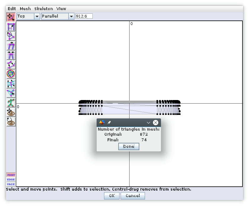

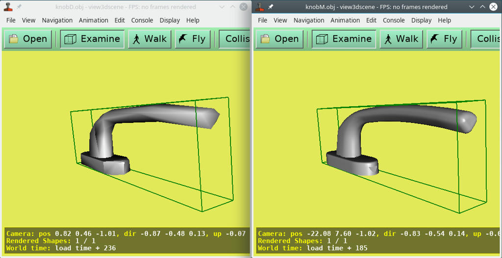

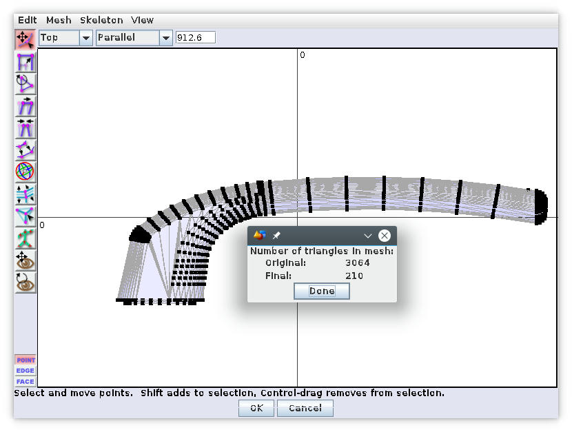

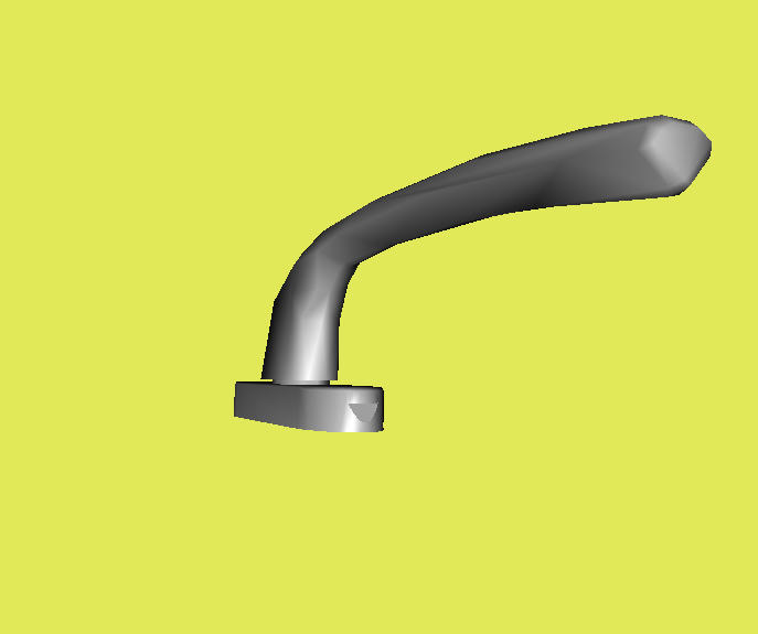

I've extract Your knob as object and this are the extreme:
Left 6.2K and right 233.3k as original.
Few information of what is behind:
You can see the numbers of triangles in original and after optimization of tow pieces which compose Your knob.
So, for me, I opted for a compromise at 113.9k which look like that:
4) If You use it for a pretty regular home is not a problem the size but for a hotel it is biggrin

If anyone is interested i can share the windows (once i change the handle) and door, as you can tell from following this topic, they will show no openings in 2d, and when modifying, all parts are called "default". But they look ok.

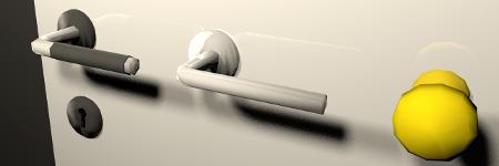

As for simplification, just for reference, in addition to Dorins simplifications, the models can be stripped down even further by following Puuybarets guide in SF 261. A couple of months ago we needed some retro doorhandles. Thinking same as Dorin, make the models as small as possible - even if these examples may be a bit extreme, they illustrate how far down you can go. I throw them in your examples for comparison.
doorhandle_retro_03.zip - 1508 bytes
doorknob_round_02.zip - 1952 bytes
door_keyhole.zip - 1244 bytes
But as Ceciliabr rightly pointed out in thread 8292 for a nice rendering of a rounded shape, you certainly need more segments in the polygon.
