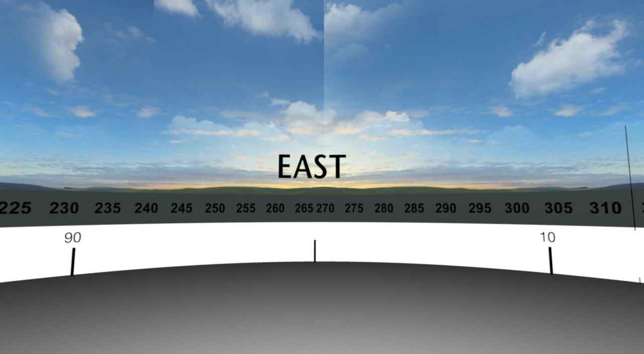

It won't display any of my projects, but I managed to play a bit and create a small object or whatchamacallit – to utilize the sky offset spinner:
With sky offset, this joint will no longer be something I have to use time on :
My first project with v6 Beta8: Horizontal_Scale.sh3d It's not perfect, but it works.
... and the new colour palette is perfect smile

confused Re: Sweet Home 3D 6.0
Everybody Didn't see that the used compass was 'wrong' since few weeks ! biggrin
A personal compass taken in my hands tell us that (like e.g. below) :
North = 0°,
East = 90°,
South = 180° and
West = 270°.
What is the Reason ? confused
Bdfd, the compass shown in Sweet Home 3D plan doesn’t show any angle.
And the X offset field of the sky texture lets the user shift that texture on the basis that the left border of the texture image will appear at the East for an offset and a compass angle both equal to 0. It could have been a better idea to consider that the left border of the sky texture is at North when its offset is equal to 0, but that would break the compatibility of previous SH3D files. I’ll see if I can add a N to indicate the North on the texture image preview to help users understand this.
