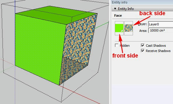

In SketchUp check if there's no color/texture on back faces of your model (even if you don't select option "Export Two-Sided faces").

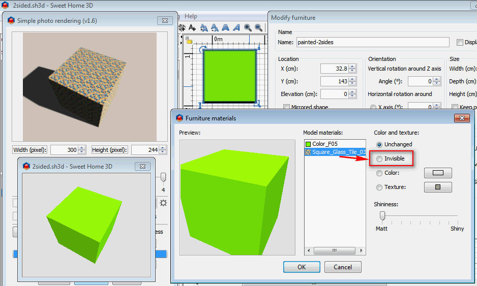

In SH3D look at materials of your model - try to turn off visibility of some of them.
