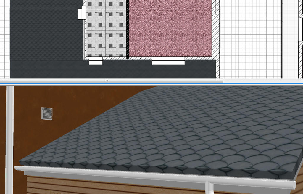

Thx okh, never been on source forge, but i may look. Another work around? and working out the centre of a sloping wall, i'll skip that thx here is an image, only a screenshot, of the fans location, doesn't seem too unusual : in it you can also see a similar affect in the 2d window where windows that are in the taller wall also appear to be in the sloped wall. Mike

You may be right - that it is a more usual combination than I thought. As it will happen with windows too (at least those with an outside wall offset and at an elevation below the top of the lower, sloped wall), it may be something worth reporting. As a bug or feature request.

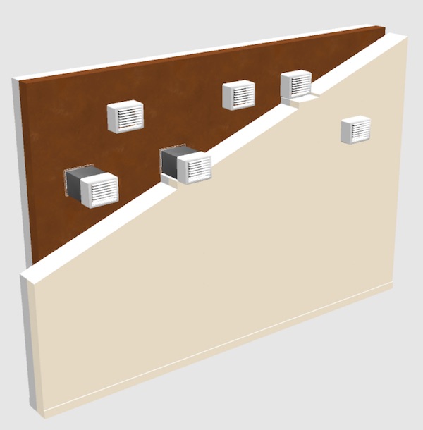

I checked it wasn't a regression introduced in a recent version, but it's not the case. When the bottom of an opening is lower than the highest point of a trapezoidal wall, Sweet Home 3D always computed "holes" in walls this way. I didn't think it could be important to take care of such cases, except if you draw two walls close to each other as you did. It will be fixed in the next version, except in case the bottom of the opening starts to intersect the wall top line (like the 3rd and 5th vents in the image below).
