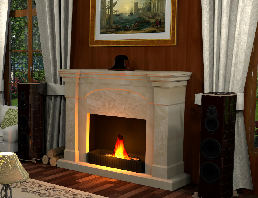

1) First, I use some mantle clock furniture objects, and somehow whenever I render them with Yafaray, the clock face is missing, like this:

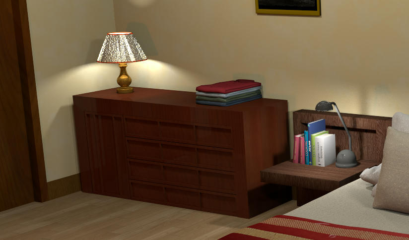

2) Secondly, the lamps (from SH3D default furniture set) are lighting incorrectly; the light "shines through," even when the lighting is set at a low percentage intensity. Like in the following example (lamp set at 7%):
This usually happens during indirect rendering (path tracing, photon mapping or sppm) with the YafaRay engine.
It seems that the light source diffuses through the object making the faces of the mesh visible.

GhyslainB's Mantle Clock is made up of 51 materials (2 colors and 49 textures).
Even by making the ForegroundColor and FrontColorNoCulling materials invisible, the problem persists.
Here is a comparative rendering without changing the source code.
