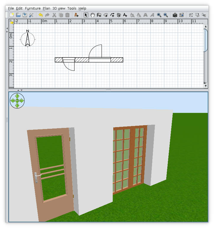

In my apartment all the doors and windows are in such position.
To solve this I modify PluginFurnitureCatalog.properties and add doorOrWindowWidthDepthDeformable#NN=false (where NN is the number of furniture).
Also, for some of them, I need to modify depth#, doorOrWindowWallThickness#, doorOrWindowWallDistance#
The result is something like this:
