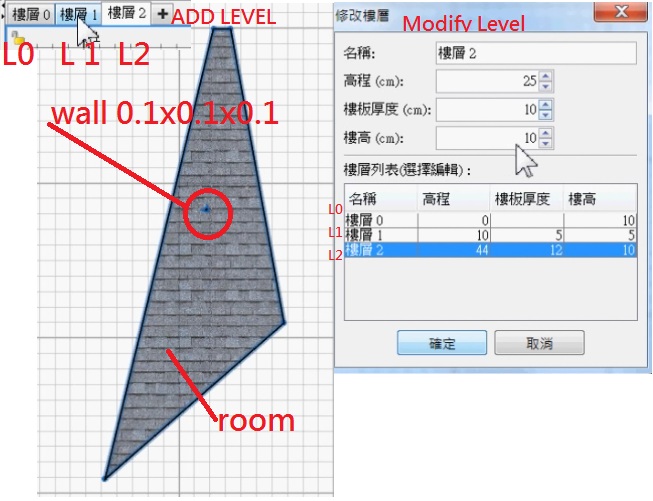

I'm sorry, I'm not able to understand the steps when you are using floors. I can't choose "Copy as new furniture" with a floor.
Posts: 4027
Re: Pyramidal roof
Post by hansmex »
To use CopyAsNewFurniture, you first have to install the plug-in. Read this PDF.

download CopyAsNewFurniturePlugin-1.1.sh3p:Here
Room cannot CopyAsNewFurniture alone, it must be “wall size 0.1x0.1x0.1 +room” together you can CopyAsNewFurniture.
see:Here or Here

Actually, I got it working and now have my first roof section, by exporting each floor directly as an object, and then importing the two floors (one for white interior finish and one with tiles for exterior, and then exporting those as an object.
CopyAsNewFurniture wasn't even needed (although I do have it installed).
