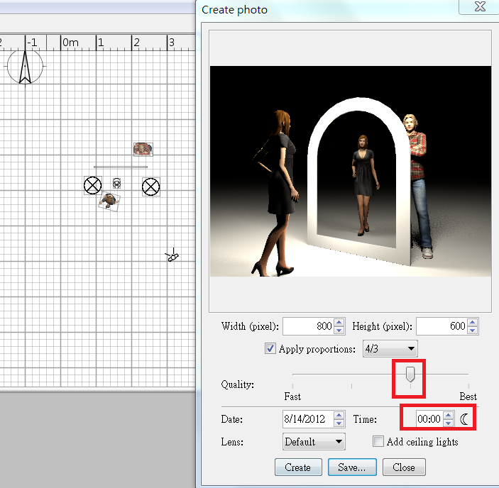

sclee, your tutorial is great but not very useful for all the people who do not understand you language(( Sorry but can you make tutorial in English?
I try to make some custom-shaped mirrors so hardly and I think that your way is easy so I want to try it but not completly understand what to do .

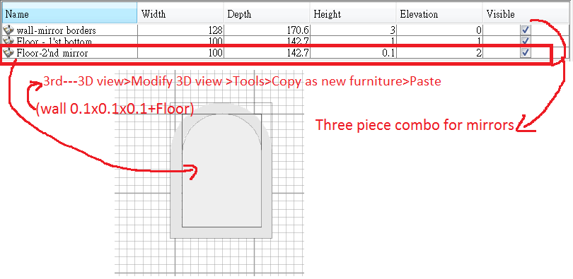

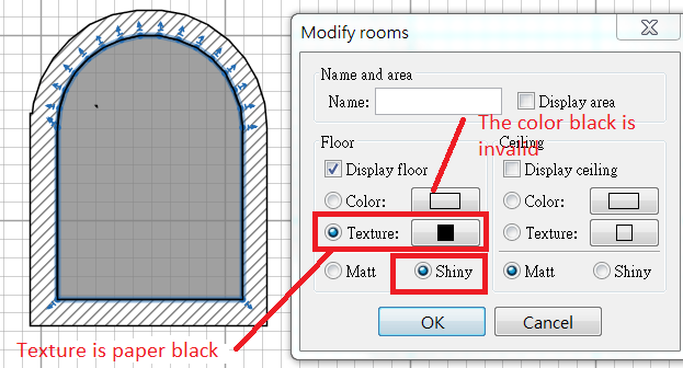

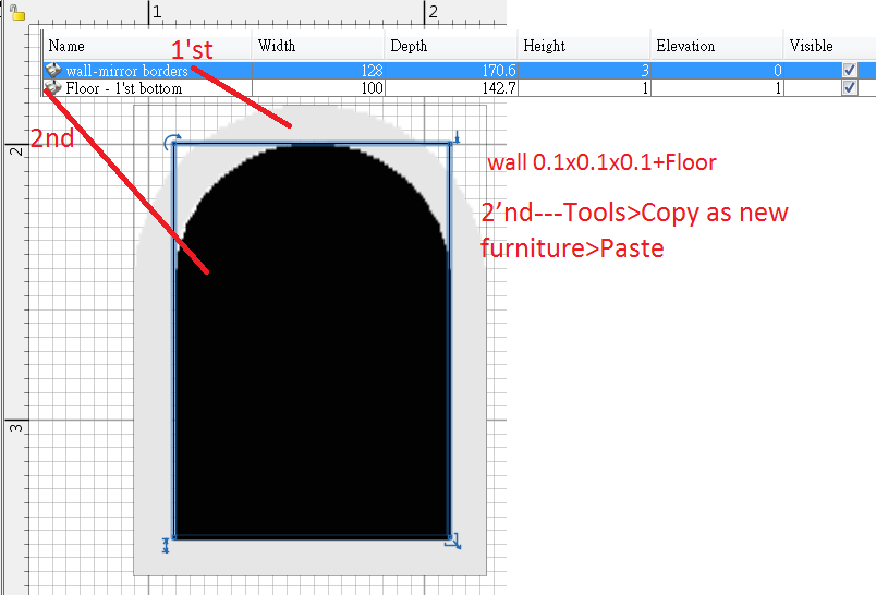

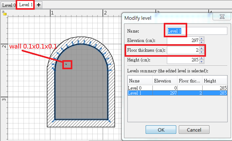

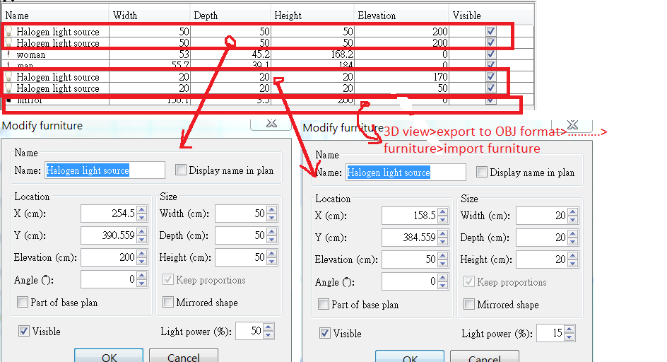

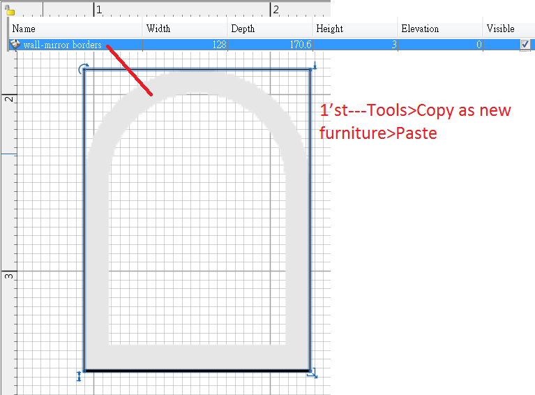

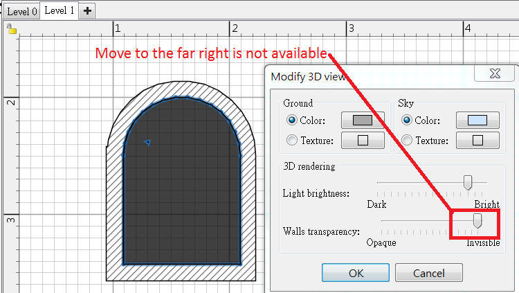

My steps are as follows:

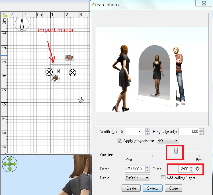

sclee, thank you for the tutorial, I really tried to do my best. But the result is not goog as you can see on my picture:
I think that I was made a mistake somewhere, but where is it? [:-/] I'll try to find, becouse I need a round mirror and some types of different-shaped mirrors...

As explained previously, the "full" mirror effect can be obtained only for OBJ parts starting by sweethome3d_window_mirror. If you want to do it with Sweet Home 3D, this implies that you'll have to use Export at OBJ format, rename the mirror part in the OBJ file then reimport the modified OBJ file.

Puybaret, yes!!! I made this! I changed the OBJ-parts as you advised and I made the mirror [:D]
Here is the result:
Many thanks to you and sclee!
