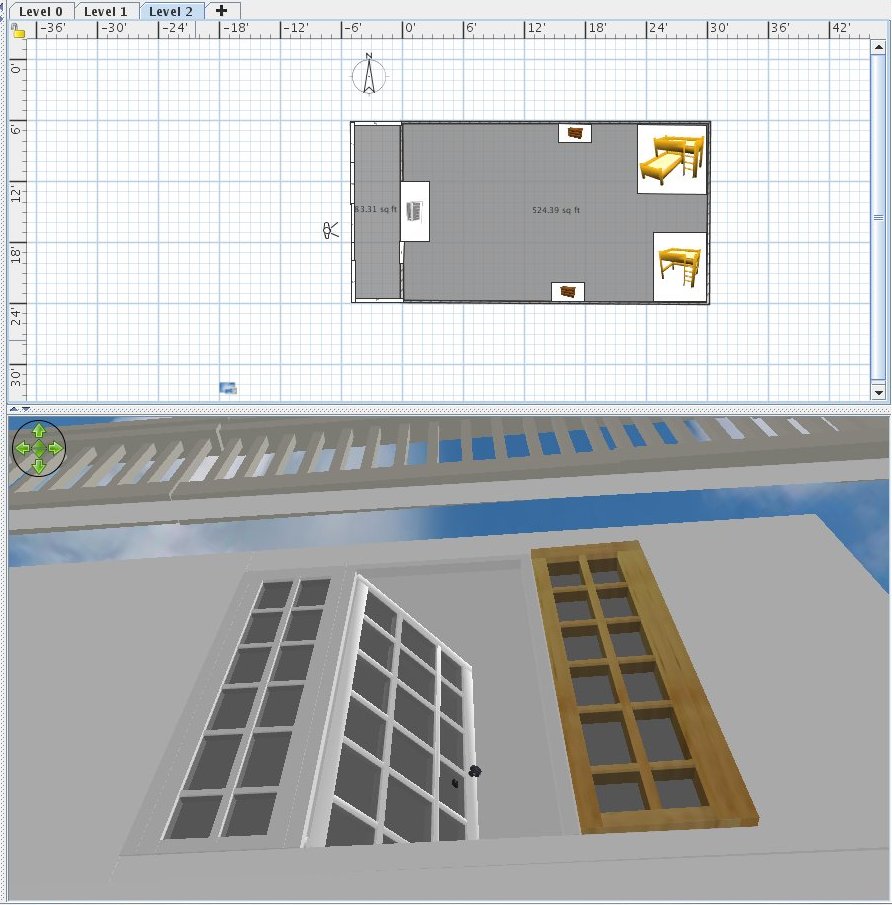

P.S. I made a balcony with a floor but when you "walk" under it, you can see right through the floor like it isn't even there. (that's funny, lol). However, when you're there standing on the balcony, you can see the floor just fine. See the attached pic (I hope it works)
This behavior happens because you didn't create a ceiling at the lower level matching the bottom of the balcony, and OpenGL faces are visible only from one side. As I'm afraid of a flow of FAQs about this, I'm probably going to improve this behavior before releasing version 3.4. The idea would be to always create the opposite (ceiling) part of upper level floors, except at the places where the user drew a ceiling at the lower level. This is not so easy because it requires to compute some intersections between the user ceilings and these opposite parts, otherwise the superimposed surfaces won't be rendered correctly.

I updated the beta version to generate automatically the bottom part of a floor at upper levels, when no ceiling part was drawn at the lower level. It contains also a few bug fixes reported by a nice team of Swedish students who test Sweet Home 3D at this time. Nice job guys! [:)]
