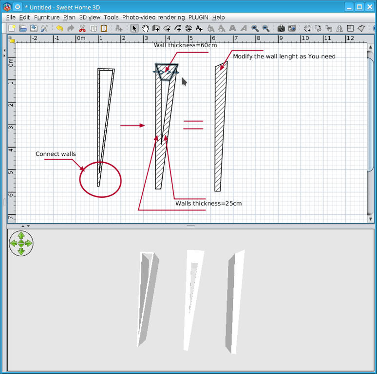

Thanks for a reply and trying. I also need walls whose faces aren't parallel, which is not unusual in older houses in my neck of woods, and which doesn't seem possible with Sweet Home 3D either, so I have to resort to SketchUp. It's quite a shame that the software actually cannot be used unless all the walls are perpendicular or parallel ...

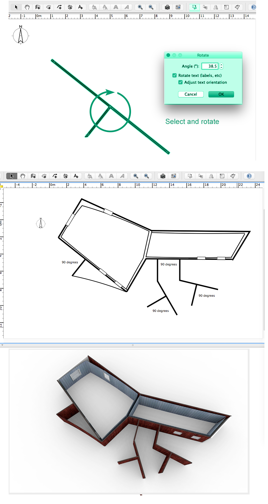

Re: Angled walls
how can I draw a wall perpendicular to an angled wall?
You draw a zero angled wall and then add a perpendicular wall.
Then you select them both an rotate the selection to whatever angle you want.
For walls with unparalleled insides and outsides, you draw them separately (of course!).

2. I have some irregular walls on my apartment. I use this trick:
[Sep 5, 2018, 1:36:28 PM] Show Printable Version of Post    View Member Profile    Send Private Message [Link] Report threatening or abusive post: please login first  Go to top
