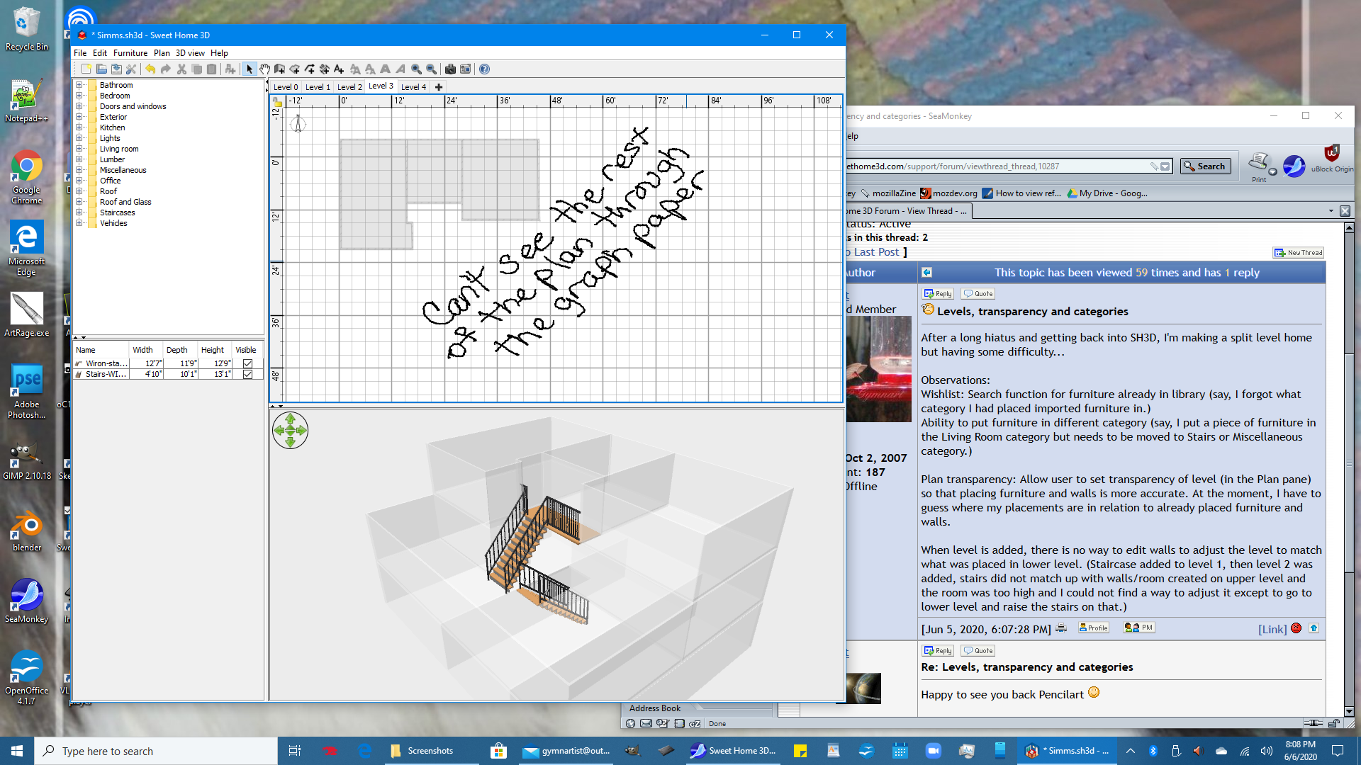

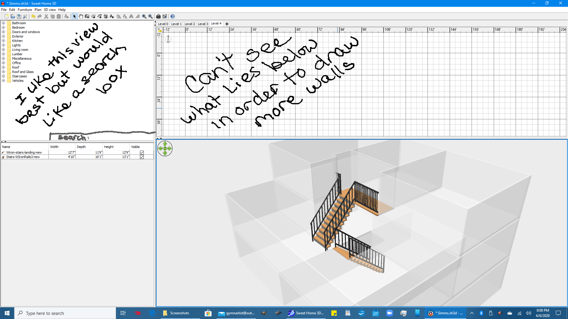

I have a couple of screenshots to show you...
<<If you added the staircase in level 1 before adding level 2, you could have drawn walls at the upper level around that staircase, couldn't you?>> ... I couldn't see where exactly the staircase was.
