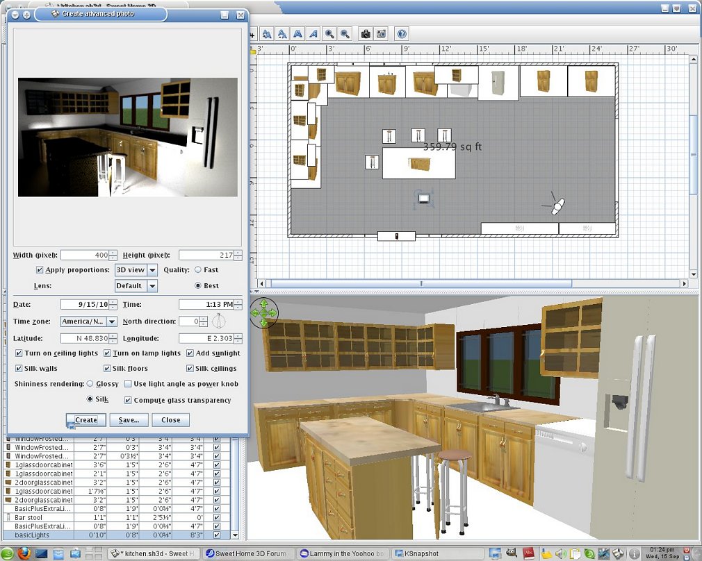

Attached is my latest attempt to render an image using the advanced photo plugin.
How do you make the lights come from the ceiling, rather than the floor? No matter what I do, they only seem to be coming from the floor. I also had put lights below the cabinets but they aren't working either. I hope you can see my settings in the screenshot.
- sh3dcrazylights.jpeg (177.26 KiB) Viewed 2922682 times

Did you try to change the elevation of the lights?
Re: How do you work the lights again?
Yes, to 80 inches and the others were at 45 inches.
P.S. the version is AdvancedRendering-1.6.sh3p and I'm using SH3D 2.6.

I might be wrong, it is a little hard to see your settings, but it looks like you have the height of the bulbs set at 80" and not the elevation? I found out through my own errors that the height of the light bulbs won't make the light go higher.. [:)] It has to be elevated like a piece of furniture.

The elevation is at 80 inches, not the height.

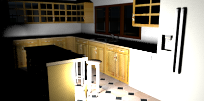

I just tried it with the regular "Create Photo" plugin and it does the same thing, the lights seem to be coming from the floor, rather than the ceiling.
I also made the elevation of the lights at 14 feet and 10 feet but that did not make any difference at all.
It just looks like the lights are upside down or something.
- kitchen.png (96.35 KiB) Viewed 644021 times

Here is a new "Fast" render (I used the new lights and new AdvancedRenderingMini-1.6.1 for this)
The problem was caused because you had a tiny height wall behind the cupboards, in the bottom right hand corner of your build, so that made the ceiling lights appear very low because the ceiling slopped down to the floor.
