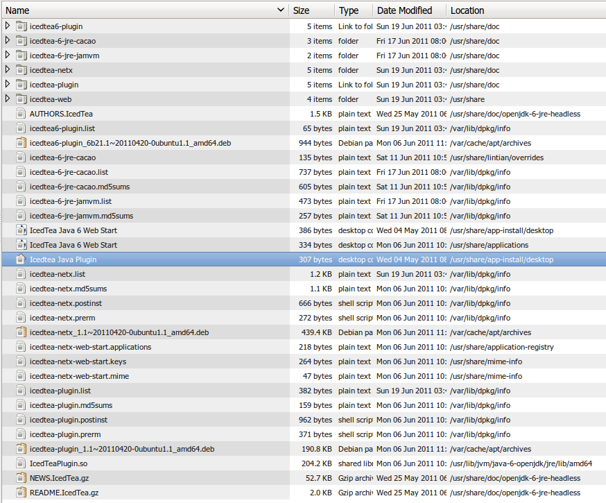

On my machine I have Ubuntu 11.04 installed as only operating system. I have IcedTea Java installed, which works perfectly.
Attached is a file that shows where all Java files can be found.

I'm not sure to whom your answer is directed, me or Emmanuel.
As for me, I wrote in my message that I'm using Ubuntu 11.04 64-bit.
I don't know what kind of Java I have installed, 32 or 64 bit: it's just the IcedTea Java that comes from the repositories. Maybe the screen shot I included in my last message tells you more?
