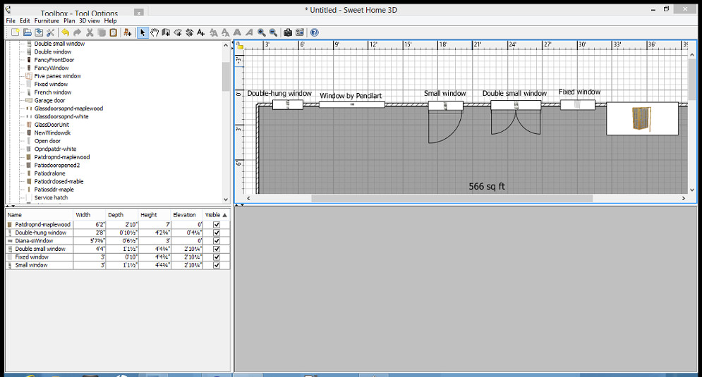

When placing windows into the plan, they are set to 0 elevation except for a few window models. I have attached a screenshot of that.
Also, I thought that SH3D allowed the user to edit furniture pieces that had been imported into the library, but I'm not seeing this now. Did it get taken out? There are some pieces that I wanted to edit.

Furniture imported from furniture libraries (.sh3f files) can't be edited in the catalog from Sweet Home 3D (or use the Furniture Library Editor), but many windows in existing .sh3f files still have an elevation.
Furniture pieces imported one by one can be edited and their elevation updated. You can recognize these pieces in the catalog because their name is written in italic.
Of course, you can always edit the elevation of any piece of furniture once you added it to the plan.
