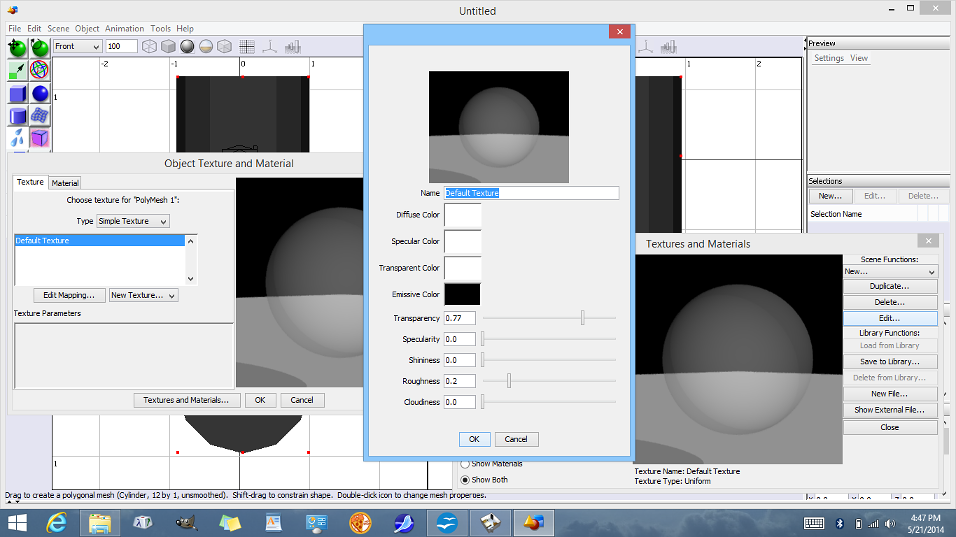

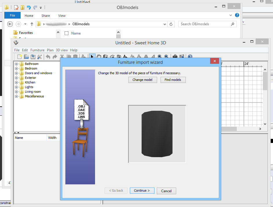

I need to track down if this problem is in SweetHome 3D or AOI 3.0:
1) In AOI (3.0) make a cylinder (or any other shape)
2) assign a transparent texture to it (all else is default)
3) export it as .obj
4) import it into SweetHome 3D
Notice the transparency is NOT transparent.
This all used to work for me in the past with no problems with transparency exports.
I have contacted the coders of Art Of Illusion too to see if the problem is there, but I just want to track this down.
P.S. I am on Windows 8.1 using SH3D 4.3 and Java 7 update 55

Hopefully I will be able to attach a screenshot:
#Produced by Art of Illusion 3.0, Wed May 21 16:44:58 EDT 2014
newmtl Default_Texture
Kd 0.23 0.23 0.23
Ks 0 0 0
Ka 0 0 0
illum 1
Still no joy.
- Screenshot (92).png (174.74 KiB) Viewed 4986318 times
