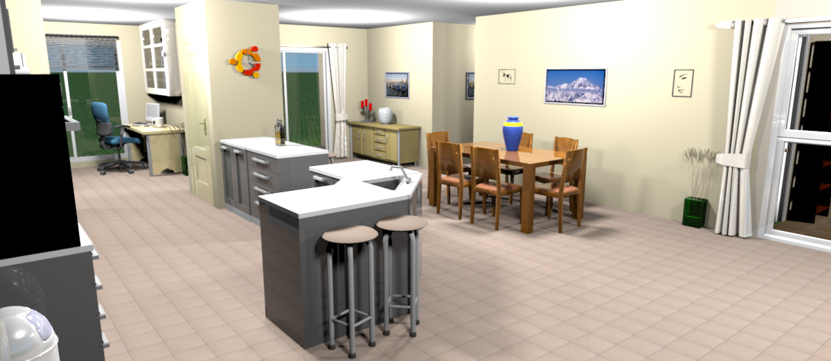

Re: Window shapes

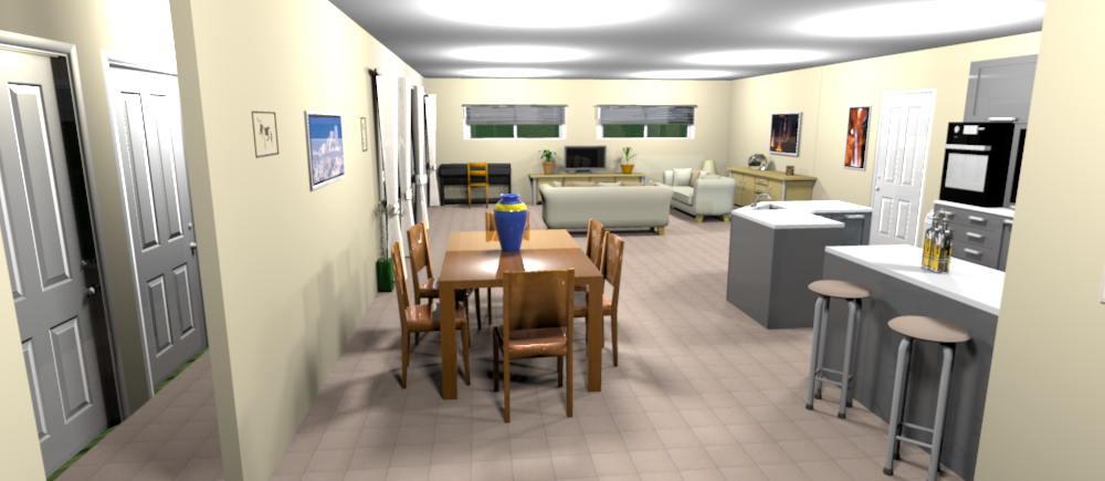

Thanks Hans,
I managed to get a visualisation by using box and triangle shapes coloured black to represent the windows.
I have been working on modelling the interior of the main living area in my house (where a large wall is soon to be removed). The results of the Sweet Homes product have been very good.
Here is the room with a flat ceiling (I am modelling with sloping ceilings presently): [;)] Thanks Hans,
- entry.png (822.94 KiB) Viewed 19685 times

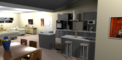

Re: Window shapes
For those interested...!! Here are some more internal pics:
- family.png (383.15 KiB) Viewed 38364 times

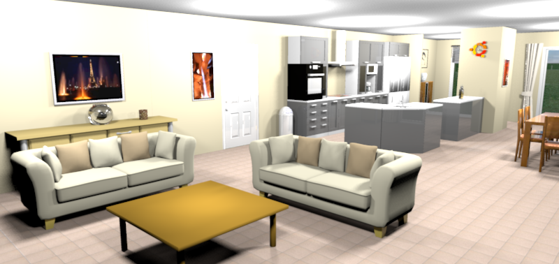

Re: Window shapes
And here is the view from the other end of the room.
- room1.png (566.55 KiB) Viewed 3137932 times

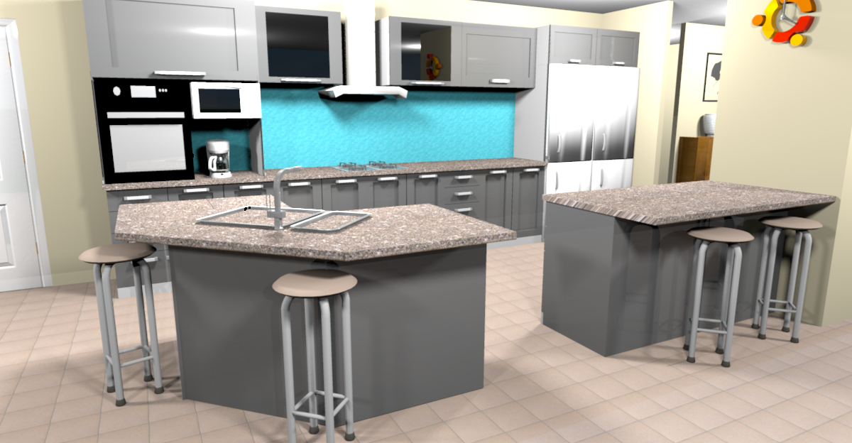

Re: Window shapes
I have also been experimenting with resizing cabinets etc to create a kitchen layout.
This has already led to my wife changing her mind on some design points!! In the picture below, I used a mirror as the glass splash-back and changed to texture to a water droplet that I downloaded.
- new kitchen1.png (953.97 KiB) Viewed 796007 times

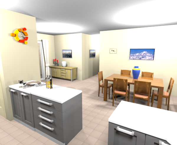

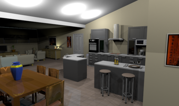

Re: Window shapes
By the way, in the kitchen model above, I used a box with th marble texture form the library afor the benches.
The main room also has a sloping cathedral ceiling and it was trying to get lights on the sloped celing that led me to this forum! There is another thread I started on the forum involving lights and sloping celiilngs - maybe I sould have posted this there.
In the pics below, you will see that the light on the celilng does not activate one the celiing is sloped. In the seceond picture, there are light sources attached (randomely at the moment!) to the sloped ceiling to light the floor area below. These light sources were lifted out of a light test room linked on one of the forums. (I think Hans drew the test room?)
The luminosity is lower than the standard ceiling light (I experminetd with sizing the light - made no change - but I will place multiple lights to mimic the actual room lighting scheme.
In the pics below, I have used a box to replicate the beam that wil be placed where there is presently a wall.
As you can see - I am enjoying using the software! Well done to the developers!
- floor2.png (239.78 KiB) Viewed 57793 times
- floor.png (112.12 KiB) Viewed 56579 times
