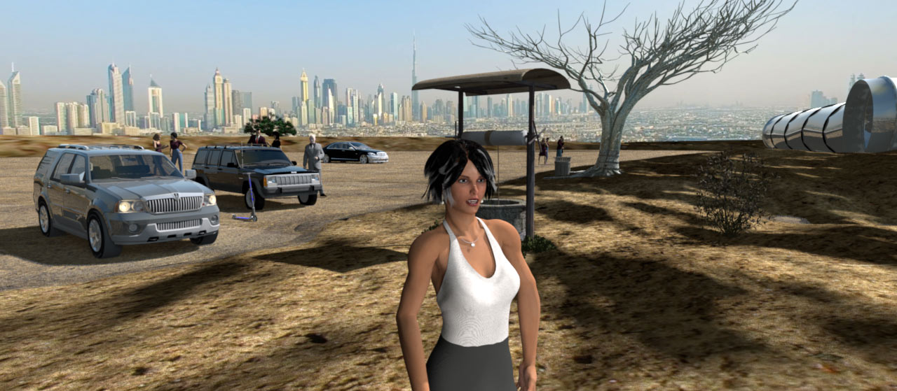

This is a larger image, rendered by YafaRay:
Rendered by Sunflow:
And to make an unjust comparison; here's a rendering made with Enko's SPR v1.8:
___________________
