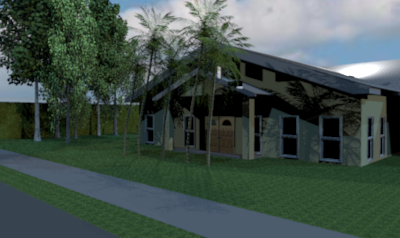

Re: Exterior modelling
I was using the high setting and was using the photo utility - I was not ussing the latest reder utility.
The file size is quite large (trees etc are quite large 'furniture' items) and if I used the anvanced renering tool, the programme would quit or else the render programme would not create anything.
Here is an example:
Here is an example:
- front-existing small.png (167.21 KiB) Viewed 58937 times
Hi Hans
I did use a picture editor to adjust brightness and contrast, but the multiple shadowing made some areas very dark.
Anyway, I was able to get the result I wanted by not using a sky texture.
Thanks for the advice.
