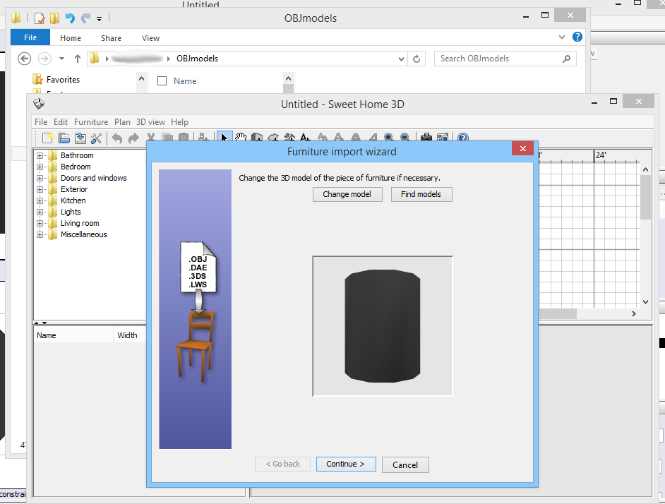

Still no joy. Hopefully I will be able to attach a screenshot:
(72076 bytes)
(Download count: 5004040)
(Screenshot 91: how a "glass" looks in SH3D 4.3 on Windows 8.1
Screenshot 92: my transparency settings in Art Of Illusion 3.0 on Windows 8.1)
(178938 bytes)
(Download count: 4986073)
